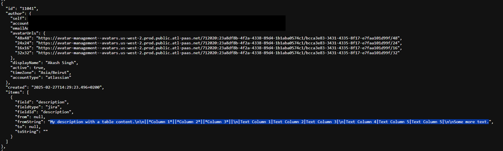

1. Fetch all the change logs on your issue using following API, you can construct the URL as following,
https://mysite-url.atlassian.net/rest/api/3/issue/<issueKey>/changelog
In the above URL replace the base URL with your instance and change <issueId> with the issue e.g. OS-8 or TP-23.
2. Find the log which describes the change in the Description field and copy the original value from the log as shown in the image below. If the response is incomprehensible for you to read in the browser, I recommend using an online json formatter tool to make it pretty and easy to understand.

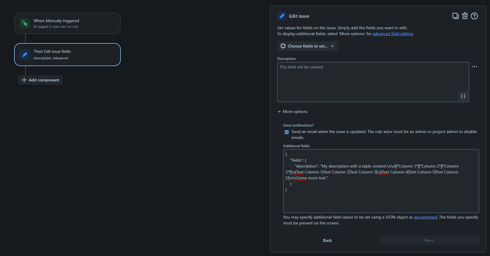

5. Add the Edit issue fields action, then expand the More options section. In the Additional fields section, enter the following JSON, as shown in the image below.
"fields": {
"description": "Paste the original description content here"

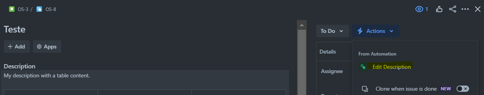

6. Save your automation rule and head back to your issue view. Now run your automation by clicking on the rule from Actions menu as shown below.
This should restore your issue description to original value, don't forget to clean up the automation rule once you are done with it.

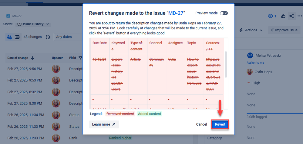

If you are open to using add-ons, it's possible to retrieve description content with Issue History for Jira developed by my team. It allows for saving formatting and rolling back changes with few button clicks.
Read about this option here: Revert changes made to the description
