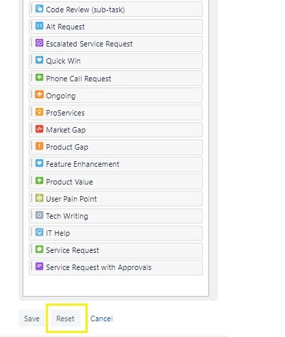

I accidentally add all issue types to Default issue type scheme. Is there any way to restore it?
I am not able to see "Available Issue type" column
I could see "Reset" but it didn't restore it

@John Funk I have created one for my project. but i changed default one. and this default scheme used by some of the projects...
I am not able to see "Available Issue types" column now because I clicked  "Add all". How can get back that column so that I can remove some of the issue type which were not in "Added Issue Types" previously

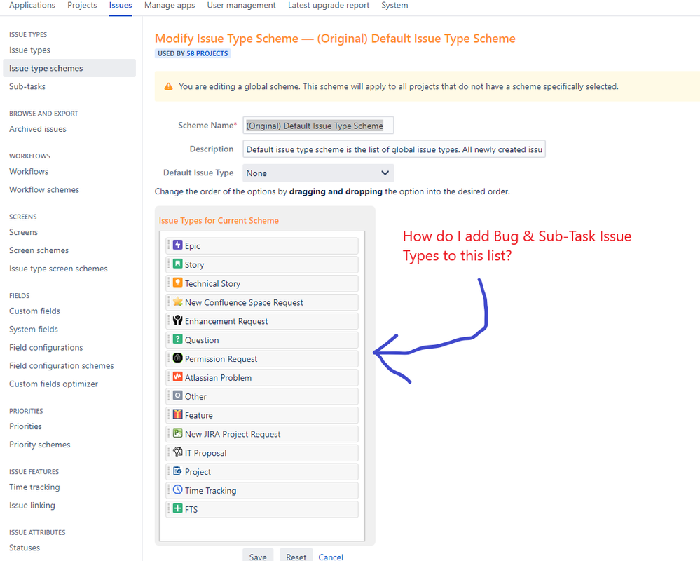

@John Funk - I'm facing a similar issue...but I still can't wrap my head around something...
I cannot seem to add sub-tasks & bug issue types to my Default Issue Type Scheme.
I understand that the default issue type scheme should have all available Jira issues by nature, and to remove them I would need to remove the issue type all together.
But what about adding issue types?
I have Bug and Sub-Tasks issue types in other schemes, but they are not appearing in my default scheme.
I was able to make a COPY of my default issue type scheme and add Bugs/Sub-Tasks, but I am unable to add them to the original Default Issue Type Scheme. Further, I cannot Delete the scheme.
Any ideas?

@John Funk - Thanks for reply!
I tracked down my issue type settings and sure enough Sub-Task is present and available within every other issue type scheme except the Default Scheme...I cannot seem to associate Sub-Tasks with my Default Issue Type Scheme or vice versa.
So, I do not believe the problem to be how you described that the sub-task issue type was created in a team-managed project.
I'm not sure how but the sub-task issue type is associated with every issue type scheme that I have EXCEPT THE DEFAULT SCHEME.
In the image below you'll see my sub-task issue type with the related issue type schemes...is there a way to add the default scheme to the list of Related Schemes?
Or some other way to make this issue type available in default scheme?
