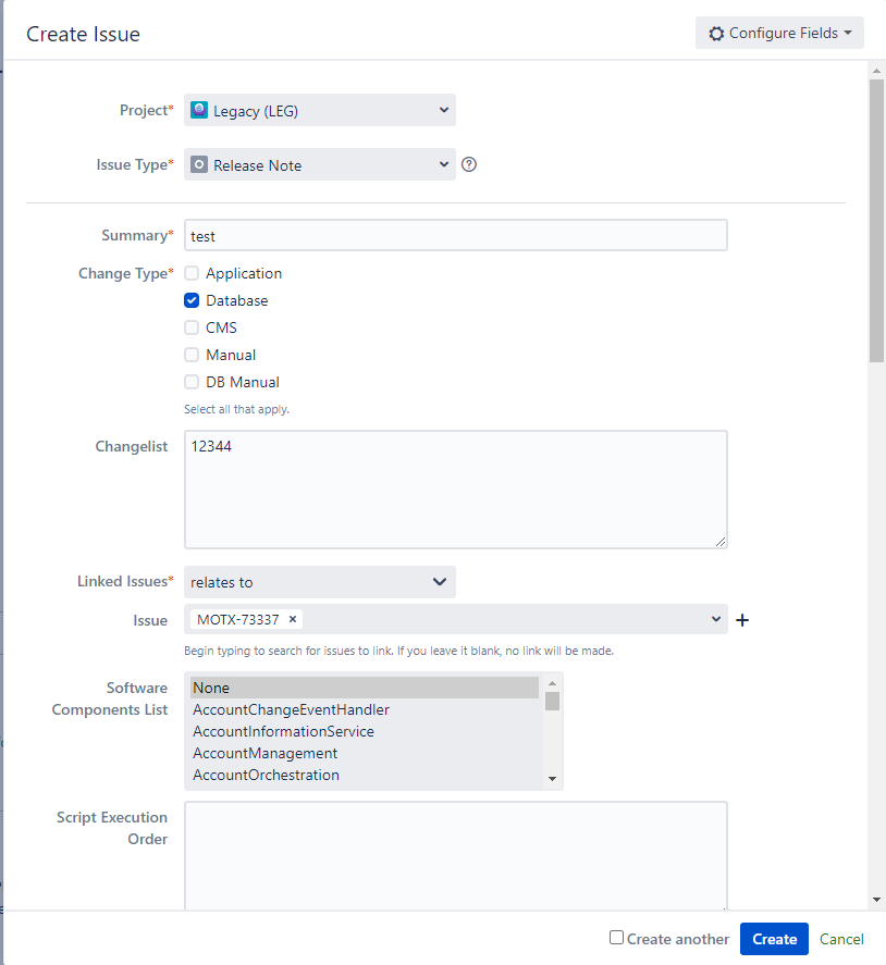

hi,
I am trying to automate the creation of release note on jira by python
the following is the jira screenshot about how to create a release note on Jira in manual way

Sunrise Zhang
October 10, 2021
hi @Fabian Lim
thanks for your reply !
there is no any restriction to complete this in manual way, I doubt the method of create_issue() doesn't support the creation of issue and linked to another issue at the same time

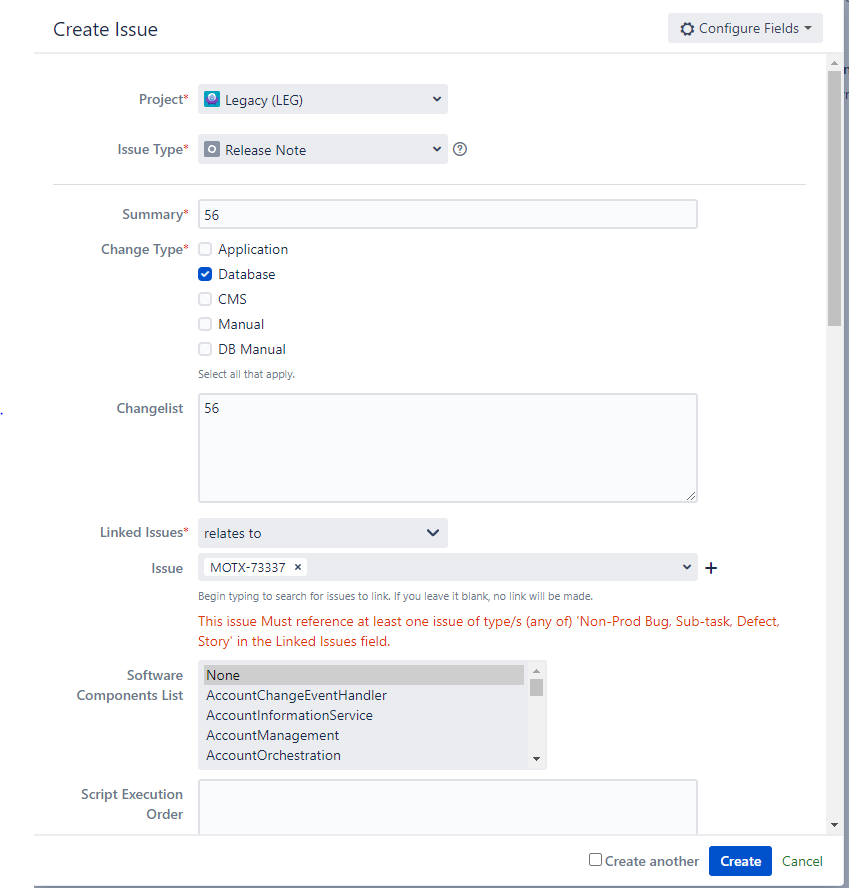

Nic Brough -Adaptavist-
October 11, 2021
The message in red in your screenshot is coming from a validator on the create issue process.
I suspect that validator is failing your attempt to create the issue.
Sunrise Zhang
October 11, 2021
Hi @Nic Brough -Adaptavist-
Thanks for your reply.
my original screenshot is a little bit confusing, Sorry for that, that message in red is due to that i didn't input any issue link in the beginning and that field is mandatory field.
I re-attached below correct screenshot as below,  there is no any issue using manual way to create a issue with issue type of "Release Note"
My questions is how to resolve the errors I met when trying to use python code to call create_issue() method to do the same thing as manual way.
The screenshot is just for your quick look/understanding about what function i am trying to achieve.
