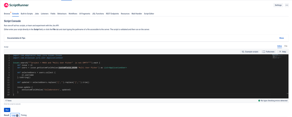

Below is the sample working code from the snippet link above:-
import com.adaptavist.hapi.jira.issues.Issues
import com.atlassian.jira.user.ApplicationUser
Issues.search("""project = MOCK and "Multi User Picker" is not EMPTY""").each {
def issue = it
def users = issue.getCustomFieldValue('Multi User Picker') as List<ApplicationUser>
def selectedUsers = users.collect {
it.username
}.toString()
def updated = selectedUsers.replace('[','').replace(']','').trim()
issue.update {
setCustomFieldValue('Collaborators', updated)
Please note that the sample working code above is not 100% exact to your environment. Hence, you will need to make the required modifications.
Below is a screenshot of the ScriptRunner Console configuration:-

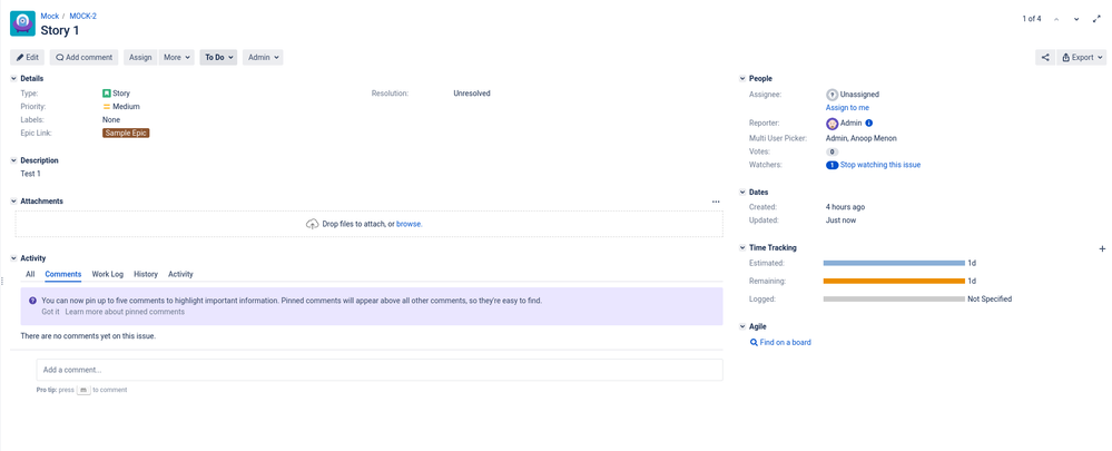

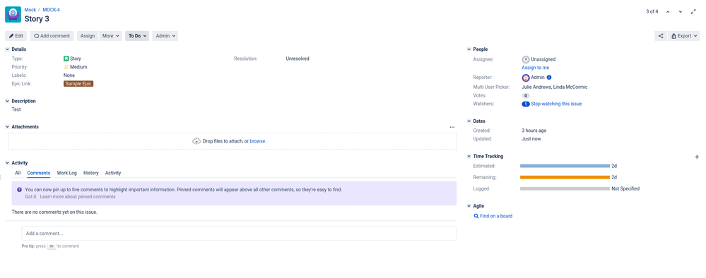

Below are a couple of test screenshots for your reference:-
1. Before the code is executed in the ScriptRunner Console, if you notice, the issues below have options from the Multi User Picker field:-

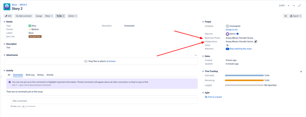

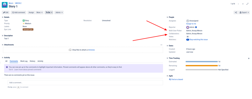

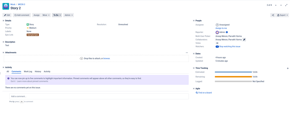

2. Once the code is executed in the ScriptRunner Console, the options from the Multi User Picker field are copied to the Collaborators field as shown in the screenshots below:-
