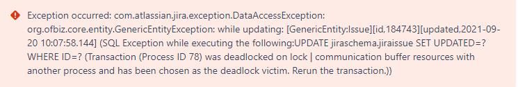

since June we have encountered an error that slows down our work.
Often, when we update a ticket, we get the error:
"Deadlock errors in logs when running Jira server with SQL Server database"
Often it is enough to repeat the action to make it successful, other times it is necessary to reload the ticket page and then repeat the action.

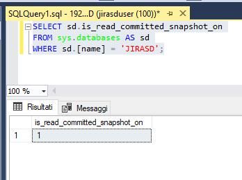

1. CLONE THE DB (since the first one was used by another application too, Decysion - xxxxxxxxx, with no success.
2. Tried the solution here with no success (https://confluence.atlassian.com/jirakb/deadlock-errors-in-logs-when-running-jira-server-with-sql-server-database-283640022.html? utm_medium = scheduledLogScan & utm_source = STP), Screenshot attached

 I've found those in the LOGS:
Line 3011: Caused by: org.ofbiz.core.entity.GenericDataSourceException: SQL Exception while executing the following:UPDATE jiraschema.jiraissue SET UPDATED=? WHERE ID=? (Transaction (Process ID 88) was deadlocked on lock | communication buffer resources with another process and has been chosen as the deadlock victim. Rerun the transaction.)
Line 3869: Caused by: org.ofbiz.core.entity.GenericDataSourceException: Generic Entity Exception occurred in deleteAll (SQL Exception while executing the following:DELETE FROM jiraschema.customfieldvalue WHERE ID=? (Transaction (Process ID 57) was deadlocked on lock | communication buffer resources with another process and has been chosen as the deadlock victim. Rerun the transaction.))
                Line 5899: Caused by: org.ofbiz.core.entity.GenericDataSourceException: SQL Exception while executing the following:UPDATE jiraschema.OS_CURRENTSTEP SET START_DATE=? WHERE ID=? (Transaction (Process ID 90) was deadlocked on lock resources with another process and has been chosen as the deadlock victim. Rerun the transaction.)
                Line 8356:     Caused by: org.ofbiz.core.entity.GenericDataSourceException: SQL Exception while executing the following:UPDATE jiraschema.jiraissue SET ASSIGNEE=?, UPDATED=? WHERE ID=? (Transaction (Process ID 90) was deadlocked on lock | communication buffer resources with another process and has been chosen as the deadlock victim. Rerun the transaction.)

The problem here is that you seem to be allowing more than one application to access the Jira database (it could even be two Jiras if you've mistakenly tried to cluster Jira without data center).  The error you're getting is down to one of them deadlocking records that the other is trying to use.
You need to set up your Jira with its own database that nothing else is trying to read or write (it's fine to have other databases on the same database server, but you should never share the Jira database with other applications)

You can't have two instances of Jira using the same database off-the-shelf, the first active one will "lock" the database, and the second one will refuse to start because it can see the first one is active.  You can, of course, hack that, but you will still find out about it very quickly as your users start complaining about crashes, deadlocks and corrupt data.
Deadlocks are not caused by corrupted data, they happen when you've got applications interfering with each other's access.  Jira has been written in a way that avoids complexity by simply assuming that no other application will be writing to the database when it is trying to use it.  So you get deadlocks when another application does.
