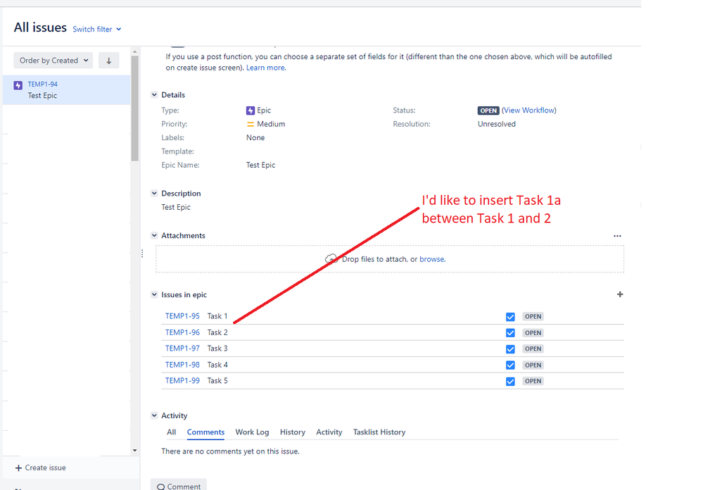

Hi Chris. I'm a relatively new JIRA user, but this is what I'd like to do. I'm showing an example of an epic with 5 tasks. I'd like to insert another one in between Task 1 and 2. Now imagine that this is list of 20 tasks and each one has a long title and description.
We try and order the tasks so that the work in the epic follows a logical flow. If I want to add a new task, I can do so by clicking the "+" button, but it will appear at the end and will be out of order.
I'm wondering if there is an insert function somewhere.

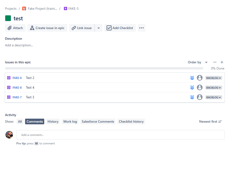

In Team Managed Projects (look in the bottom left of the screen to check) you just drag and drop them to re-order them.  Just create a new ticket, then pull it into the order you want.

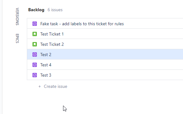

In a Company managed project (I suspect you're in one of those) you would do this from the backlog view.  I have a backlog/board that sees the child tasks, and the query for it is "ORDER BY RANK ASC", so when I move up/down the individual task tickets, they appear re-ordered in the Epic.
Hopefully these help.  (so TLDR, do that from a backlog that can see those tickets, AND has "ORDER BY RANK" enabled on the query", then just drag it into the position you want).
