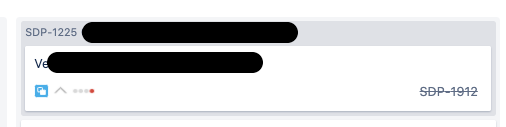

The subtask displayed in the board should have a small header above it that identifies its parent issue, like this - SDP-1225 is the parent and SDP-1912 is the subtask
Subtasks can be ranked only relative to the other subtasks under the same parent. Beyond that, they will show in the column in the same position as their parent issue's rank relative to the other story/task/bug issues. You would need to change the rank of the parent issue to change the position of the subtask.
