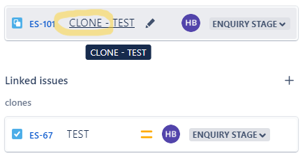

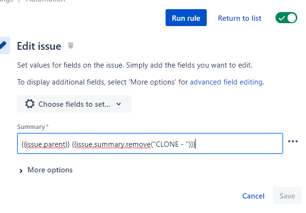

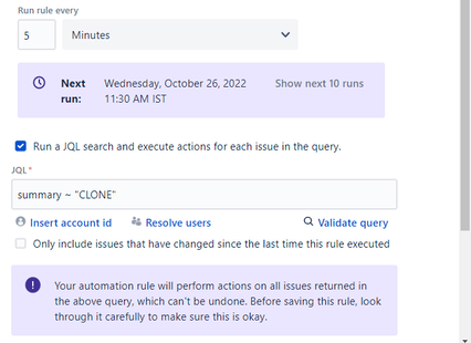

Hey guys, I have difficulty using automation. I tried doing it but it seems it isn't working. I don't want "CLONE -" in the summary of my issue and subtasks after cloning them. Please tell me what am i doing wrong. Thank you.

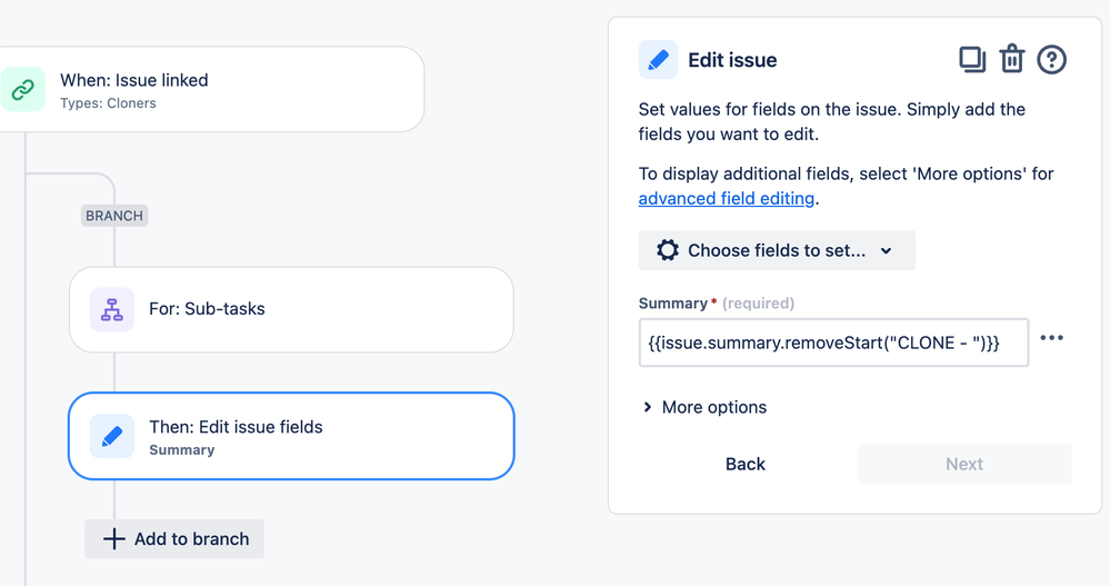

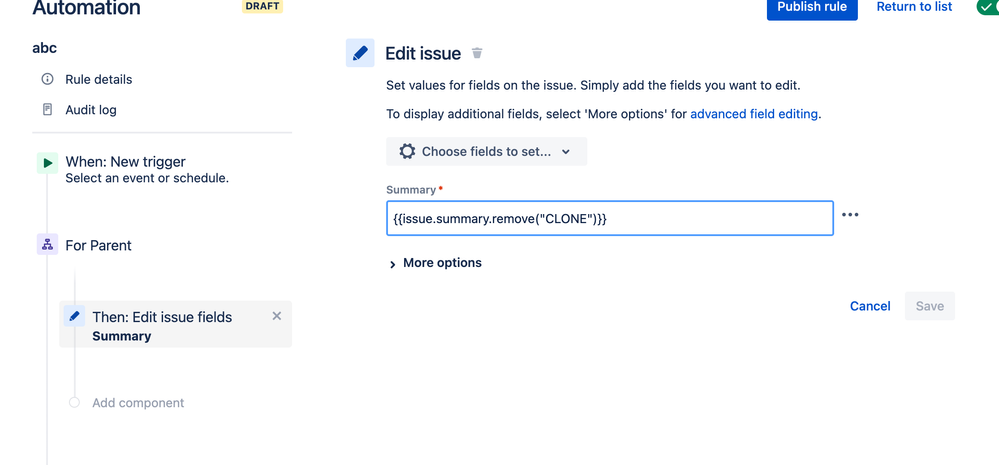

Hi @Ronneth Dhanish ,
1. you need to create a branch rule for parent
2. Then choose edit issue as the new action
Cheers!

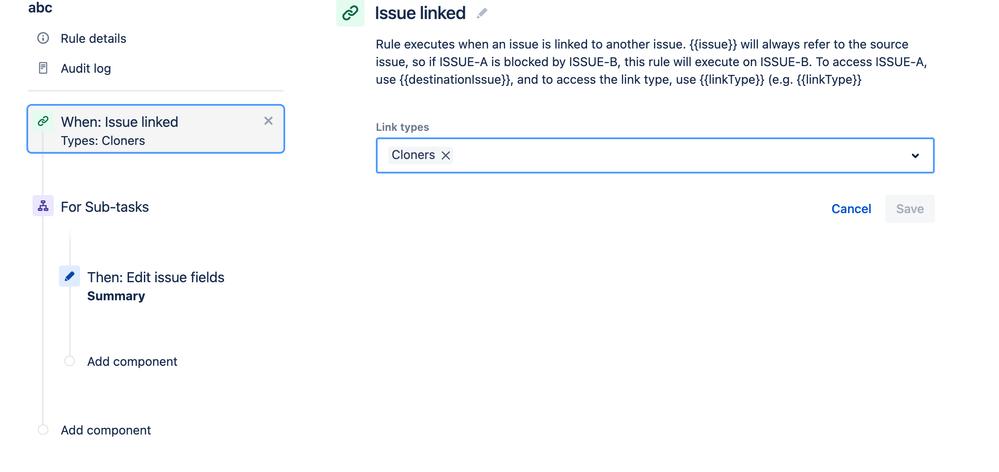

You can use Issue Linked trigger. check the attachment

Tharaka_Hettiarachchi
October 26, 2022
yes create branch rule which triggered only for subtasks

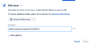

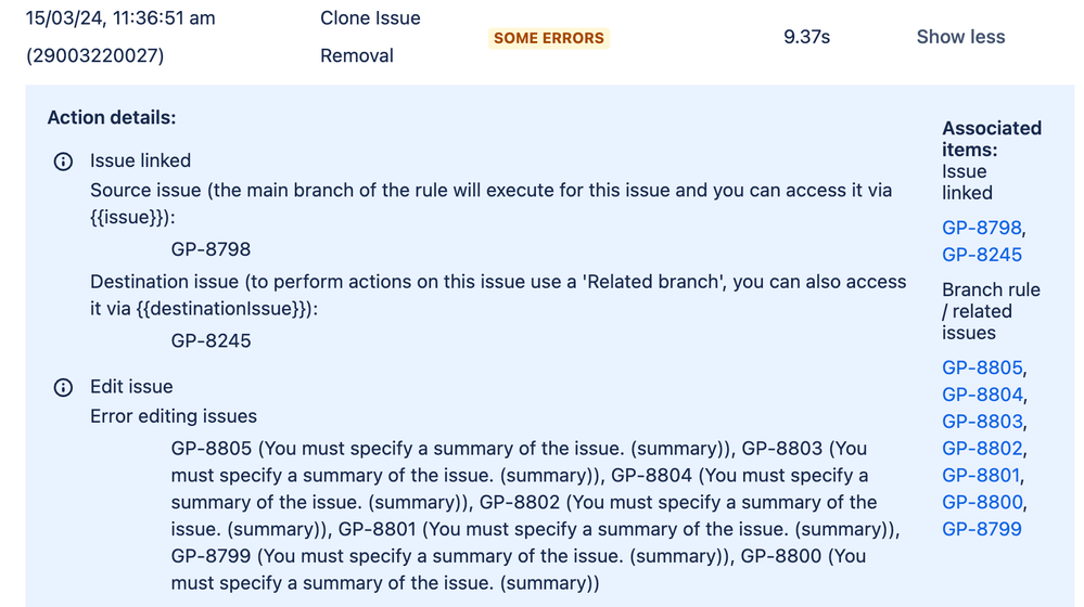

Hello people I tried but it does not work for me.
I have got this error
This is the rules-setting
Daryl Marsh
June 25, 2024
but add in the hyphen with spaces
Like Jan de jongh likes this
