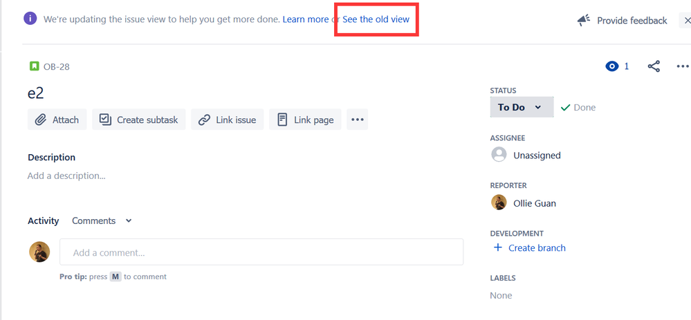

Switch to the old view mode, delete the due date field information when editing Issue, then save it.

I tried a business project and was able to switch to the old view mode.
