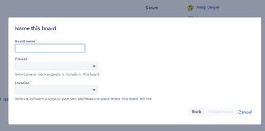

actually...it may be possible. At least in Cloud.
I haven't tried this but it may work and worth a try.
Why this might work:
Boards created against your profile as the location do not show up in any project by default. But you can create a link to the board within the project. So you should be able to add the link in the one project and not the others.
Again, this may only be available in Cloud and it may not meet your needs.
It does makes sense, but as I am not in the cloud:+
I do not get the Location option.

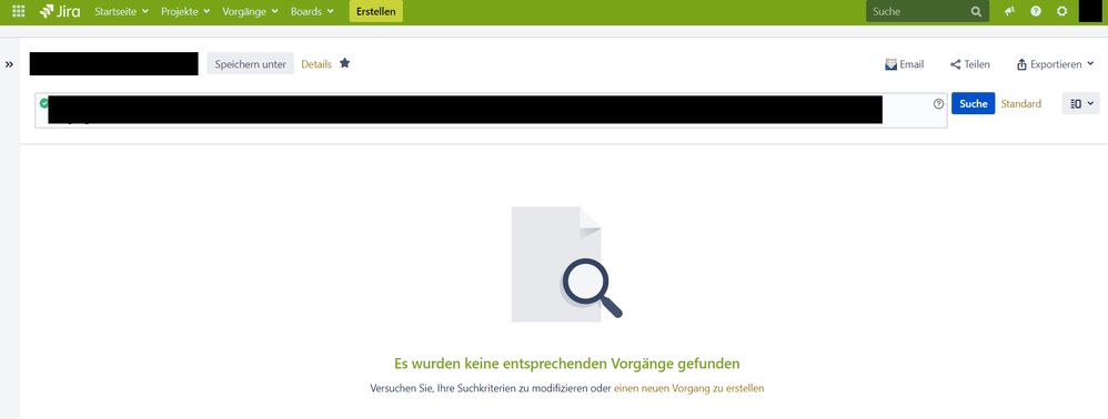

So, we use Jira 7.8.1. In order to remove a project from a board, I did the following:
1. Navigate to the board by clicking the "Boards" dropdown button on the main menu bar, then select the board you want to remove a project from.
2. In the upper right-hand corner, click the "Boards" (dropdown) button, and select "Configure"
3. From the General tab of the board's configuration, find the "Saved Filter" entry, then click the "Edit Filter Query" hyperlink below it.
4. This brings up the "Filter Query" page. In the upper left corner, is a dropdown button with the board name. Click this button, and it beings up a dropdown list with all the projects, whether they're related to the board or not. Find the project you want to remove from the board, and UNCHECK the box on the right hand side of the project name.
You can also use this a quick way to add a board to a project.
Hope this helps. Good luck!
Thank you Michael! This was the straight forward resolution
Where is that button supposed to be?

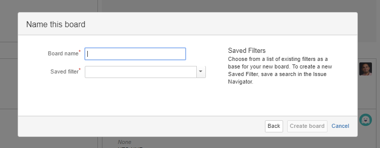

On our Jira Datacenter 7ff I have observed the following:
- boards using private filters appear only for the owner (which is rather clear)
- if a board filter has a share (i.e. is shared with anyone) it will appear if you use "project" in the underlying filter.
If you do not use "project" in the filter then the board does not appear in the project view.
Workarounds for filtering on projects are
using the issue key, e.g. "key >= ABC-1" or
to use project categories and then to filter on the project category, e.g. "category = myProjCat".
So for me it seems like the board is shown in the project only if it is shared and the underlying filter uses the "project" field for filtering.
