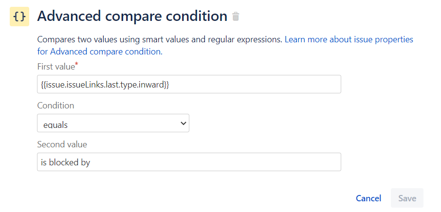

Bill Sheboy
May 21, 2021
Oops... My bad: you cannot check that in the trigger as the "blocks" and "is blocked by" are tested at once.  Instead you would add an advanced compare condition for the last added link after a generic linked trigger.
