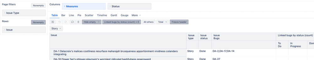

Hi @Samuel Srungarapati
Please import both projects into the eazyBI and use the GetMemberByKey() function to get all the properties.
In Eazy Bi create a measure Linked issue by status count
Sum(
--go through all linked Bugs
Filter(
DescendantsSet([Bugs].CurrentMember,[Bugs].[Bugs]),
--check if linked Bug Priority matches selected Priority
DefaultContext((
[Measures].[Issues created],
[Issue].[Issue].GetMemberByKey(
[Bugs].CurrentMember.KEY),
[Status].CurrentHierarchy.CurrentMember
)) > 0
--aggregate linked Bugs ignoring the Issue Priority
([Measures].[Issues created],
[Status].CurrentHierarchy.DefaultMember)
