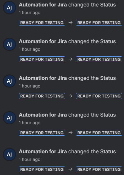

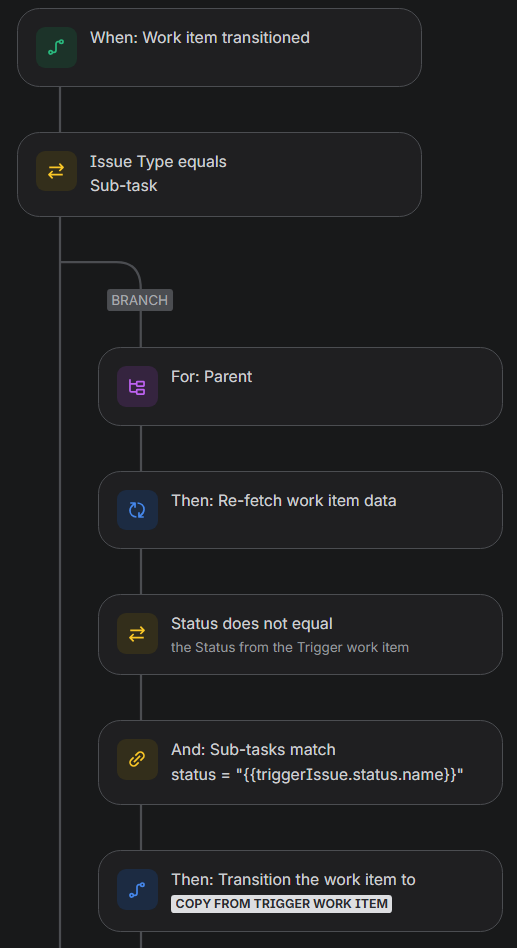

I use Jira Cloud and set up an automation to transition a task when all its subtasks are transitioned. It works, but if for example a task has 10 subtasks, and I transition all of them together, the automation triggers and transitions the parent task 10 times. Is there some way to prevent all these duplicate transitions? Screenshots of the automation and duplicate transitions in the task history are below. Thanks.

This is definitely a racetrack timing situation, and may require different approaches to solve, depending upon your Jira license level:
When you have Premium or Enterprise Cloud, the Delay() action is available and could be added after the rule starts to pause the action for several seconds.
Without those license levels, and even with them occasionally, you may need some rule restructuring to help.  For example, you could explicitly check sibling subtasks before proceeding:
  • trigger: Work Item Transitioned
  • action: Re-fetch Work Item Data
  • condition: Issue Type equals Sub-task
  • action: Lookup Work Items, using JQL to find all sibling Sub-tasks which DO NOT have the same status as the trigger one
parent = {{triggerIssue.parent.key}}
AND status != "{{triggerIssue.status.name}}"
AND issueType = Sub-task
  • smart values condition:
    • first value: {{lookupIssues.size|0}}
    • condition: equals
    • second value: 0
  • branch to parent
This approach focuses on first slowing down a bit with a re-fetch on the trigger work item, and then explicitly checking the sibling sub-tasks...which will take a bit more time.  Then, only proceed if we are on the last one, whereby the condition passes.
Even with this approach, it could still fail to work correctly...particularly when Atlassian is in the midst of an automation outage, slow down, etc.  One belt-and-suspenders approach would be using two rules:
  1. Your current rule, instead of transitioning the parent work item, sets a flag value in the parent.  This may be done with a custom field.
  2. Another rule with a Scheduled trigger, runs every 5 minutes or so, and uses JQL to identify any parents which need transition based on the flag, using the custom field to decide what to do, and then clearing the flag in the parent on the way out.

Unfortunately, the first solution doesn't appear to help. It's either still too fast or the delay is too uniform to prevent the race condition.
That said, clearly the second solution would work, if I decide that the longer delay is worth the clean history. It's just a shame there's no other viable option on a standard license.

Your rule is almost correct, but the duplicates come from parallel executions when multiple subtasks transition at the same time. Each execution checks the parent before it has been updated by the others, so they all try to transition it.
One important improvement: instead of using ā€œCopy from trigger work itemā€, try setting a fixed target status (e.g. ā€œReady for Testingā€) and add a condition like:
parent status ≠ ā€œReady for Testingā€ or something like that.
This makes the rule idempotent and prevents repeated same-to-same transitions.
You can also keep the Re-fetch issue data step to improve consistency, but the key change is avoiding the dynamic ā€œcopy statusā€ action.
