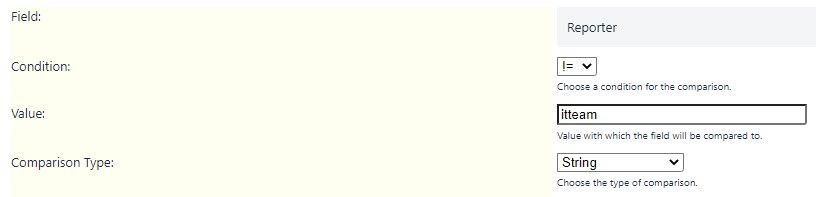

Hi Kristian
This thread partly answers the same query I have but I am using Conditions as I'm not skilled enough to write Java Compliant Expression. Is there any way to add a user alert when the workflow transition condition is not met? This is my current Condition setup:
