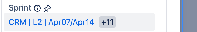

Hi @Karan Sachdev ,
When we manually close a sprint and move issues from this sprint to next sprint, we could see issues in the newly created active sprint.
In the sprint field of these issues, we could also see how many sprints these issues have been through. Pls refer to the screenshot attached.

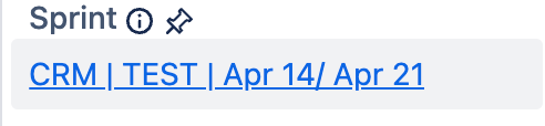

But, while we update sprint value for an issue from Automation rule-> Edit Issue-> Advanced fields using below payload,
"fields": {
"customfield_10020" : {{createdSprint.id}}
it replaces the entire list with a single sprint ID and previous sprint details are lost.
Is there a way to replicate what happens during manual sprint movement in automation rule as well?
"fields": {
