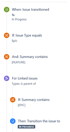

@Lalithesh Thanks for your quick response! I tried to recreate the steps for the "linked work item" example you drafted above - does this look correct?
Lalithesh
August 6, 2026
Looks great! @Jamie Kent
One thing I'd like to confirm is the selected link type ('Is parent of'). Could you please share a screenshot showing how the Epic and Feature tickets are linked? That will help me confirm whether the configuration is correct.
Otherwise, if the Epic ticket is linked to the Feature ticket using the 'is parent of' link type, this should work as expected
Cheers!

Yes, they're linked using the 'is parent of' and 'is child of' linkage type.
Lalithesh
August 10, 2026
Thanks for sharing the screengrab @Jamie Kent
Since the Summary is redacted, I'll assume the ticket linked via "is parent of" is the Epic. If that's the case, your automation should work as expected :)
