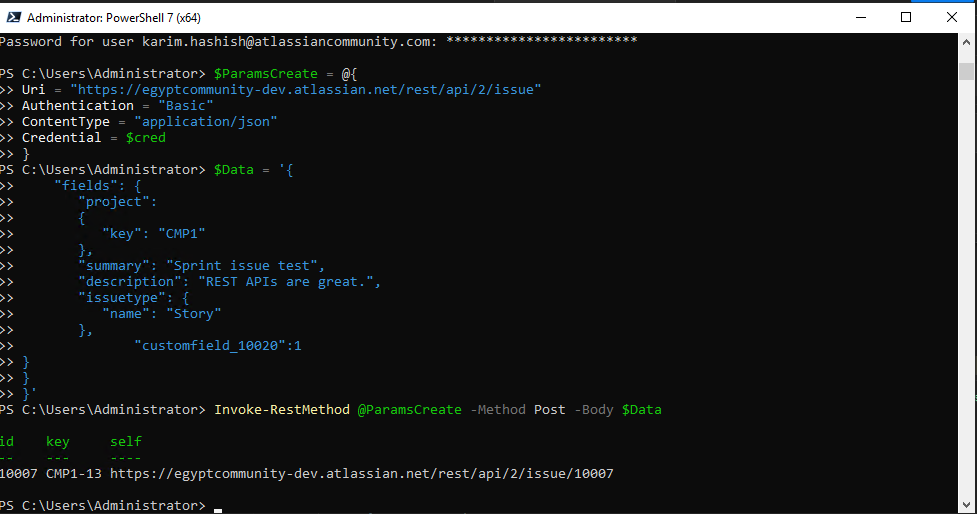

You can set the sprint value during the creation. The only trick here that you should not use the field name "Sprint", you have to get the "Sprint" field ID in JIRA. This link will help you for this point.
Below is a Sample Powershell code for creating and JIRA Issue within a specific sprint. In my case my JIRA Sprint field ID was 10020 and active sprint ID was 1 (highlighted in bold).
Powershell Code
# Use your user name (email address) and the password is the API Key
$cred = Get-Credential
$ParamsCreate = @{
Uri = "https://egyptcommunity-dev.atlassian.net/rest/api/2/issue"
Authentication = "Basic"
ContentType = "application/json"
Credential = $cred
#Json Data for JIRA Ticket details
$Data = '{
"fields": {
"project": {
"key": "CMP1"
"summary": "Sprint issue test",
"description": "REST APIs are great.",
"issuetype": {
"name": "Story"
"customfield_10020": 1
# Create the JIRA Ticket within my active sprint
Invoke-RestMethod @ParamsCreate -Method Post -Body $Data

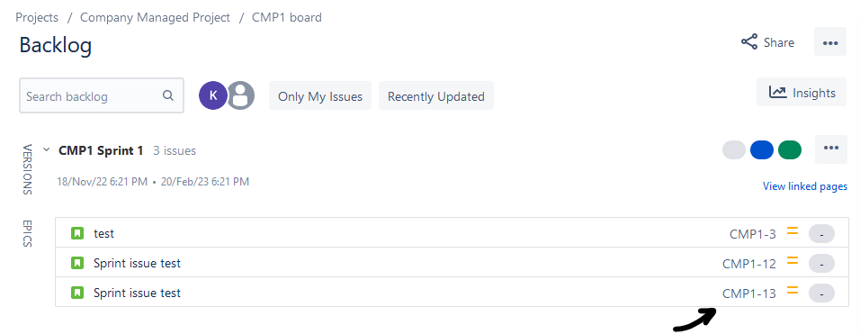

Code Results
JIRA Check

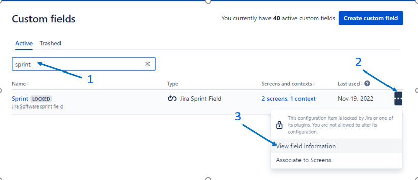

You may try the below steps (tested on Cloud Version)

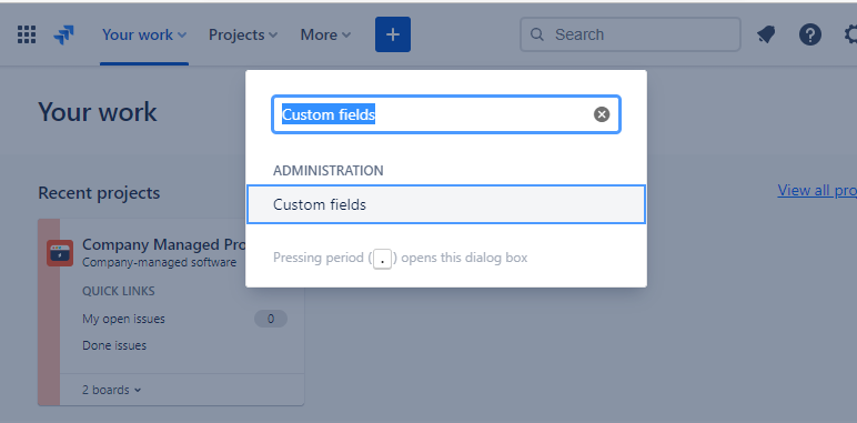

  1. While you are logged in, type gg or --> it will pop the special admin menu, then type custom field.
  2. Search for the field sprint, and from the 3 dot icon on the right, select view information

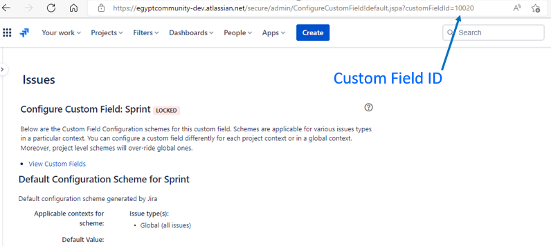

  3. You can find your sprint field ID in the URL
