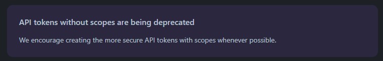

As unscoped API tokens are already deprecated i wonder if basic auth for API calls will also be deprecated in favor of only supporting OAuth 2.0 authentication in the future.

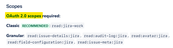

Me too. But I find out using basic authentication with OAuth 2.0 does work. I create API Token with scopes and call the request to GET /rest/api/3/issue/{issueIdOrKey}. It worked. The URL is https://api.atlassian.com/ex/jira/{cloudid}/{api}. Cloudid is your site cloudid and you can get it from https://{yourdomain}.atlassian.net/_edge/tenant_info. Api is the url, like rest/api/3/issue/{issueIdOrKey}. Then go with Basic authentication and username is your email address and the password is your API Token. If the http response code is 401, it means the API Token scopes does not match. If the http response code is 404, it means something wrong about the http request structure.

The steps from @shaozihao works for me.
It seems like the URLs that we expect to use:
https://<vanity-name>.atlassian.net/rest/...
simply do not accept scoped personal API tokens with 'Basic' auth. An unscoped token would work, but a scoped token is quietly ignored and results in the anonymous response.
Once I switched to the internal URLs (using the ID from the "tenant_info"):
https://api.atlassian.com/ex/jira/<tenant-uuid>/rest/...You must be a registered user to add a comment. If you've already registered, sign in. Otherwise, register and sign in.

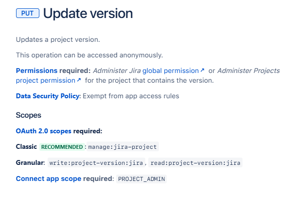

I saw that you tried granular scopes such as delete:project-version:jira , read:project-version:jira and write:project-version:jira. It is just a guess, but have you tried using the classic manage:jira-project scope? I found some information in this Update version.
It is just a guess, I'm interested to hear what others have to say!
