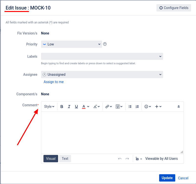

1) When I try to edit an existing issue, the Comment field is set to required as shown in the image below:-

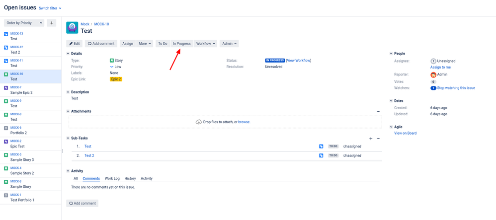

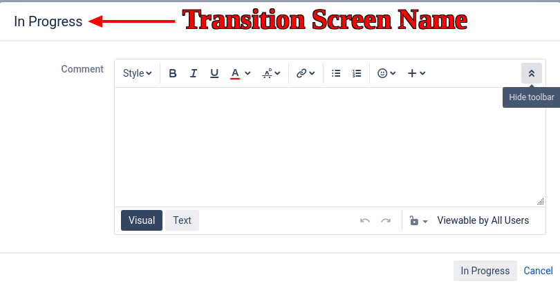

2) If I try to transition my issue to In Progress, in which I have added a transition screen with the name In Progress, the Comment field is not set to required as shown in the Images below:-
