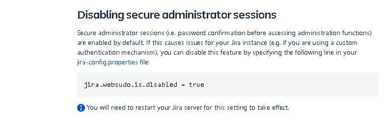

#1. reference.

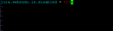

#2. the content of jira-config.properties.

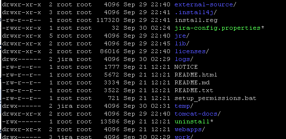

#3. the location and the file right.
