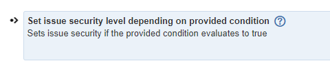

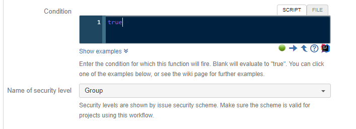

In fact this has been confusing for myself as well. If I understood correctly when the issue is in the first status only users in "analisti" should be able to see the issue right ? In that case define the security level as follows (replace BAL with analisti)
image.pngThen use this post function :
image.pngOnly users in the group "BAL" will be able to view the issue :
Antoine.

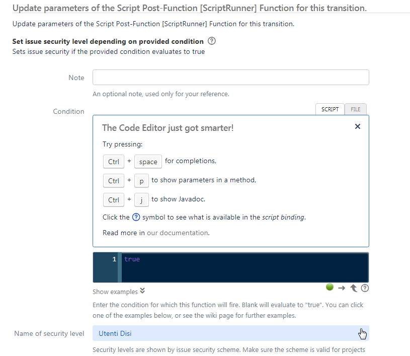

I'll attach a few screenshot.
I defined a issue security scheme as suggested, then modified "Create Issue" post function as your in screen, but "zanni" is still able to see new issues.
Please note that "analisti" group does not contain "zanni".
Where am I wrong?2019-04-23 11_30_06-Edit Issue Security Levels - Gruppo PAM JIRA.png2019-04-23 11_31_09-Update Workflow Function Parameters.png

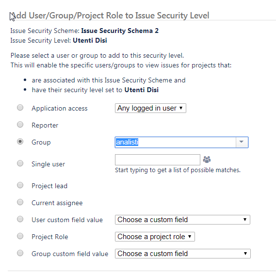

Antoine Berry
April 23, 2019
Could you also attach screenshots of the security level configuration (Utenti Disi one), and confirm that the security level is correctly set on the issue after creation, just as on my previous screenshots ?
Thanks.
Marco Barbaro
April 23, 2019
2019-04-23 14_40_32-Add User_Group_Project Role to Issue Security Level - Gruppo PAM JIRA.png

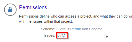

Antoine Berry
April 23, 2019
Make sure the issue security scheme is linked to your project :
image.pngIf this is not the case, go to the project configuration and click issues :
Then you should be able to see the security level on the issue.
Antoine
