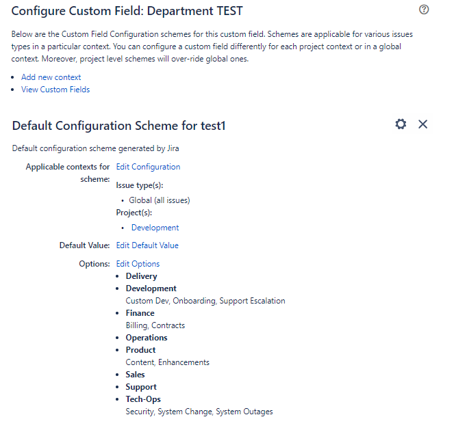

Hi there
I am new to JIRA and would like to know how I can make a field mandatory in a single project and  not across all boards.
Unfortunately I tried to make a required field, and turned out that no one could create a ticket, due to this mandatory field that was not even showing on their boards.
Goal: Make this field below mandatory for only DEVELOPMENT project
Thanks
Heres a screen shot of current filed:
2 votes

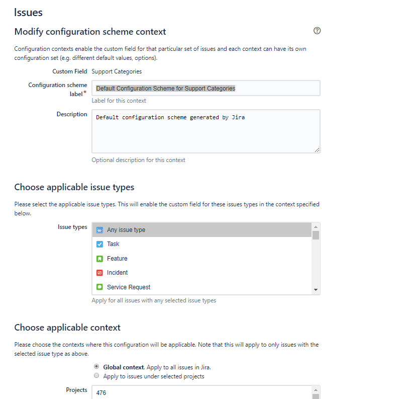

A little bit. Thats one thing that i have been confused about. So lets pretend I create a custom field:
  1. Custom field is created
  2. Under Custom Field Context theres the following: jira1.PNGWhich i a can label anything under Configuration scheme Label and apply to any issue type/ if its global or to a specific project- correct ? Once this Scheme is created - I have to ADD A FIELD CONFIGURATION and linked this FIELD configuration Scheme to it , correct ?
John Funk
April 16, 2020
Yes, that's correct.
