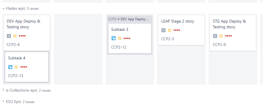

I have a Kanban board that shows work-items grouped by Epics (i.e., Swimlanes are based on Epics) and under an Epic rows I can see stories plus if there are sub-tasks under that story then those too inside the story card.
For the above view my board's filter query is basically "project = projectName" which means the board is showing all the epics but I want to see only a few epics. Is there a way to retain the above view/layout and show only the epics that I would want to see?

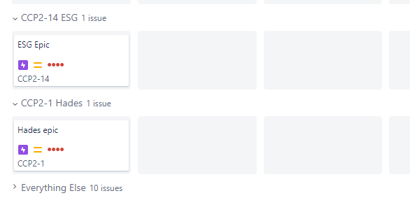

When I use "issuekey = PROJ-1140 OR parent = PROJ-1140", those two epics themselves are seen (screenshot attached) under the swimlanes but not the child items of those epics as seen in the original view pasted along with initial query which is what I would like retain but only for a few epics instead of all the epics in the project.

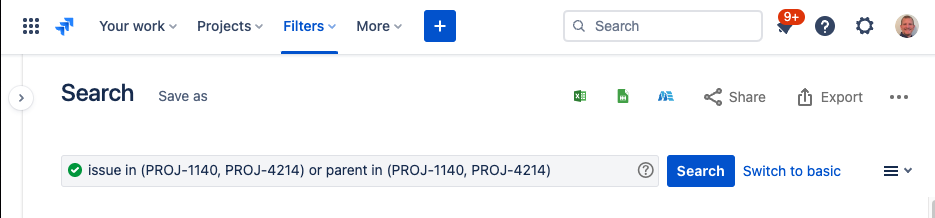

You could try this:
issue in (PROJ-1140, PROJ-4214) or parent in (PROJ-1140, PROJ-4214)

Same result still. Board is empty.
Garrett McCreery
May 2, 2022
To continue the investigation, can you try this same query in the Advanced Issue Search under the Filters menu, to see if you are getting the results correctly.
That will narrow down whether or not its a board issue.
