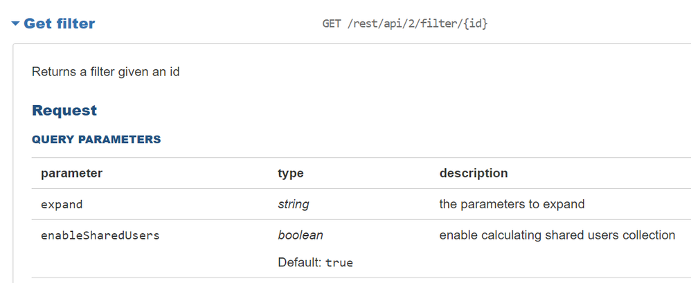

I am trying to extract data from filters as shown below. May I know how to know the API name and version to fetch data from my filters?
Burak Kaya
February 22, 2021
Hi there,
The API URL is written at the top-right of the page. (GET /rest/api/2/filter/{id})
It means the URL should be http or https://{host_name}/rest/api/2/filter/{id}, and request type should be "GET". Also authentication should be basic => user:password.
But apart from that, If you want to get the list of issues in a filter, this API does not work for you. It just gets the details of filter.
You have to use "Search" api. It gets JQL, max size and fields parameters and provides you get of list what JQL returns. I believe this is what exactly you need.
https://docs.atlassian.com/software/jira/docs/api/REST/7.6.1/#api/2/search
