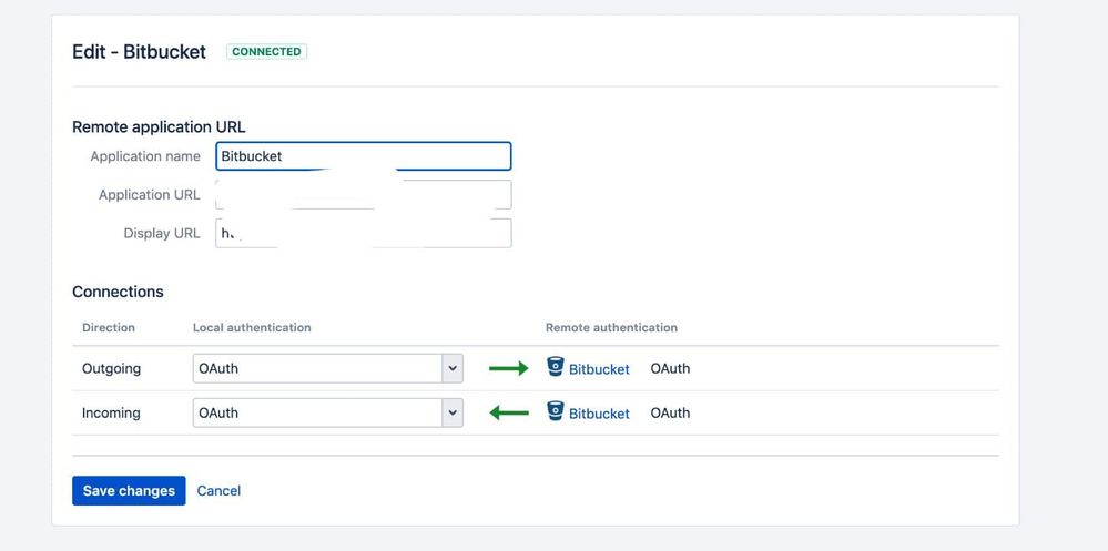

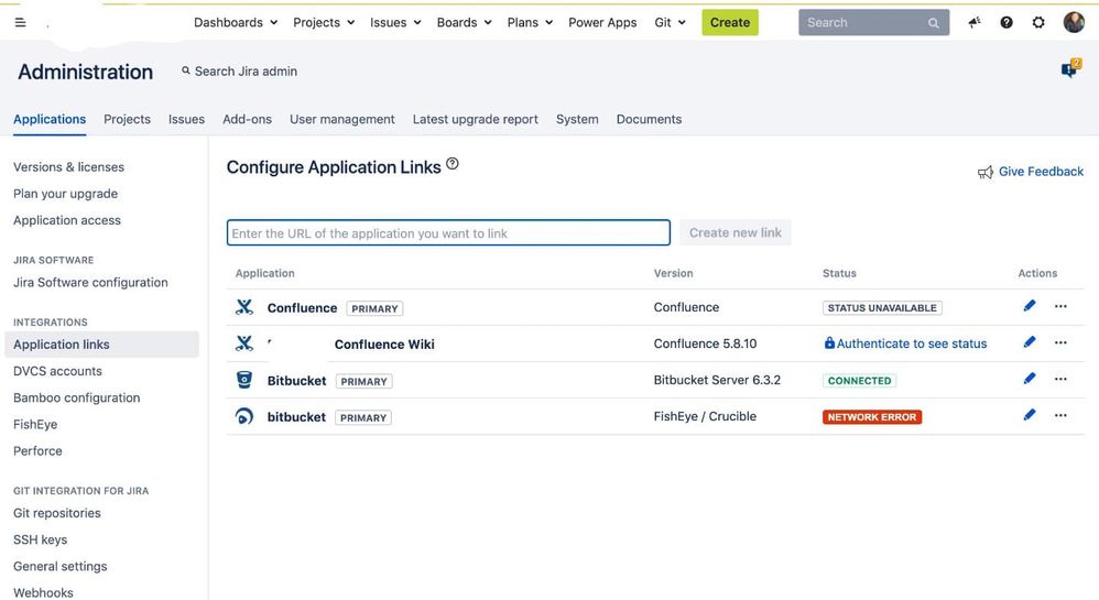

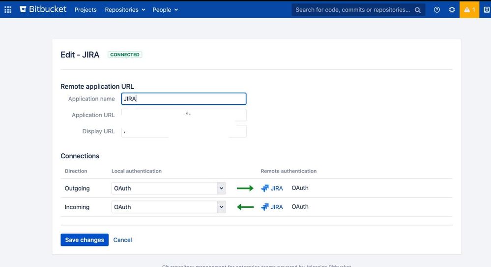

It looks like I have Application link set up on Bitbucket (Jira) and Jira (to Bitbucket). Why the Jira ticket still showing "You have no license installed"? See attachments.

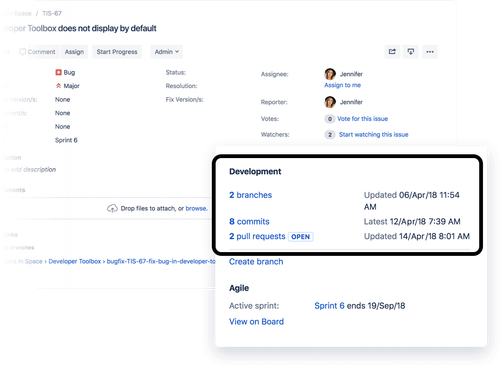

Okay, so that is not from Bitbucket, if a Jira issue is associated with a branch/commit/pull request in Bitbucket you will see something like this:

Yes, the error is coming from the app, and you can can go to add-ons > Manage add-ons to see what apps you have installed. The screenshot you included above is for Applications links, which is different from add-ons/apps.

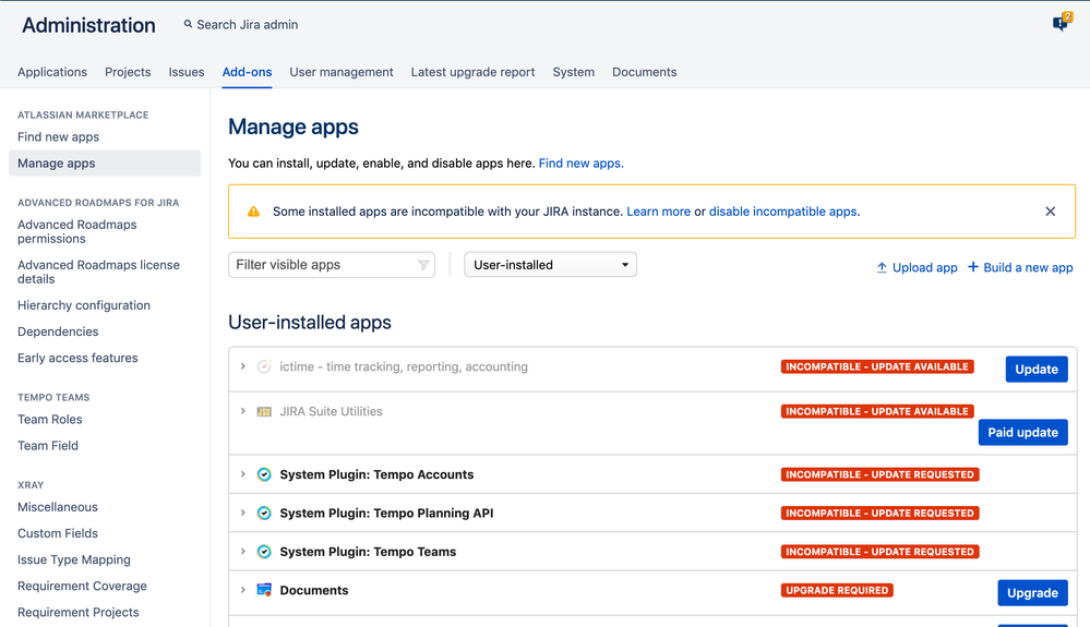

Back to the JIRA error message. I do not see "add-ons > Manage add-ons" that you mentioned. I found "Add-ons > Manage apps". Is this what you are referring to? Please see the attachments for the screenshots.
You said I do not need additional app for Git. Is the error invalid? I see "Git integration for Git" is in RED on the list. See attachment. Is this the issue? Do I need to remove it? Once removed, how can I connect with Bitbucket (See the first paragraph for my issues with integration)
Thanks. B.
Yes, it is Git Integration for Jira that is giving you the error message you see (the red you see under Manage apps just means that you need to upgrade the app). That app is not needed if you are using Bitbucket, and you have already set up the Bitbucket/Jira integration. I would consider to at least to disable the Git Integration app, that will remove the error message.

In order to link a Jira issue to Bitbucket, and also see the Development section on an issue, all you have to do is create a branch that starts with the Jira issue key, mention the issue key in a commit, or mention the issue key in the description field when creating a pull request in Bitbucket.
