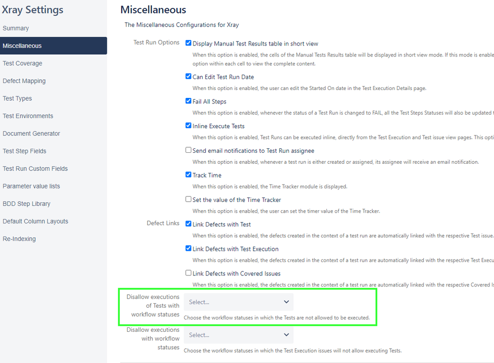

Hi @Varun Kumar
within your xray settings there is a configuration that avoids executing tests within a specific status - in your case "closed" (see the screenshot below). As far as I understand the error correct I assume this could be the cause for the problem. Please check that configuration and let me know if this is the case.
Hope this was helpful.

I will get that checked but actually tests do gets executed though they are closed but issue comes while creating execution ticket using the results.
I will get the suggested Xray configuration checked (may be something my company managing on organisation level and not project level.)
Many Thanks for your response, much appreciated.
Varun Kumar
June 23, 2023
Thanks @Stefan Salzl
As you suggested this setting was causing the issue. Thanks a ton for your help on this.
