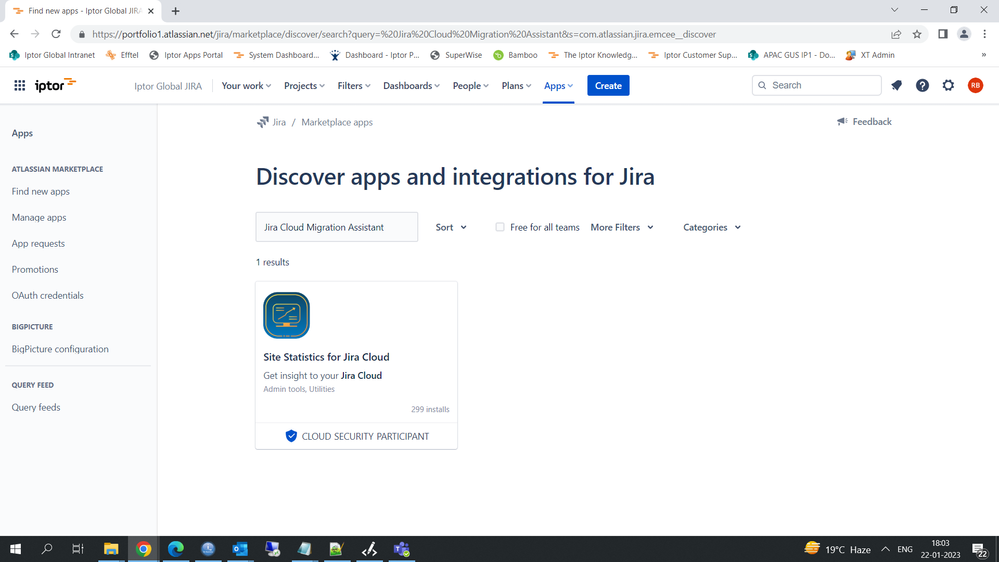

Thanks a lot for your reply. I tried to search for JIRA Cloud Migration Assistant in JIRA marketplace but couldn't find this app. Can you please check and suggest from where can I download this utility. Thanks in advance.

Hi @Rahul Bisht --
Jira Cloud Migration Assistant runs on your on-premises instance, so you'll need to install it there. Here is the marketplace listing:
Documentation on installing and running it is here:
