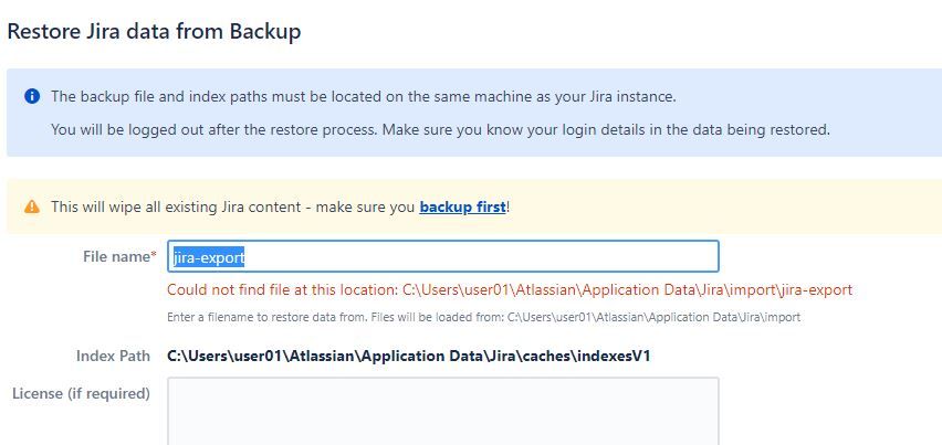

Hi! I'm trying to migrate projects from one Jira Cloud instance to another using "Jira Cloud Migration Assistant" I understand that first I need a backup file, import it to one Jira server instance, then export it from server and import it to the new Jira Cloud instance. The problem is when I read the documentation is that the only way in which I can import that backup file to server is while I'm installing it.
There is another way in which I can import that file to the Server instance that is already installed? 3.JPG

Hi Petter, thanks for your answer. I was trying to use Jira Cloud Migration Assistant because I need to migrate 4 cloud sites (instances) into 1 and I need to keep the sprints information.
Reading this document ( https://confluence.atlassian.com/jirakb/merge-multiple-instances-of-jira-cloud-779160767.html ) I've found that the assistant let me keep that info. That's why I've tried to use this method.

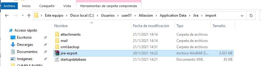

But I've got another problem, in the server instance when I try to import the zip (backup from cloud) my server instance doesn't find the file. And I've placed it where it's supposed it must be. So I couldn't test or try any method yet.
Can you tell me why is that? Thanks
