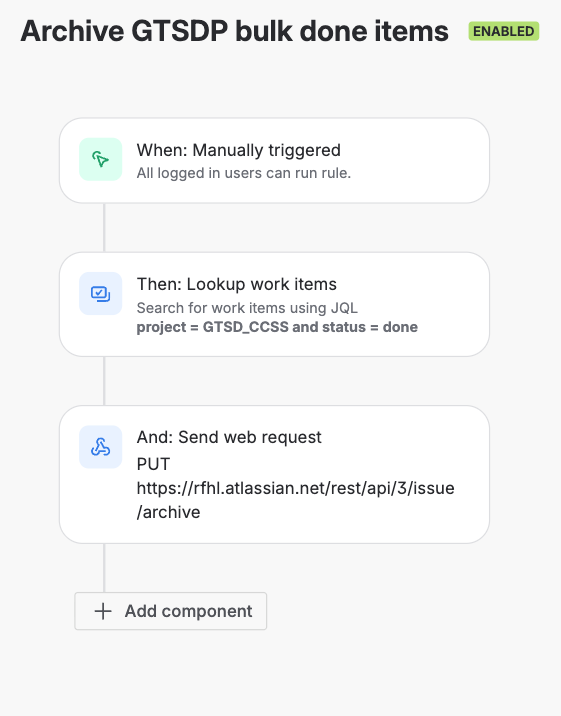

I created a rule to bulk archive "done" items using Jira automation. I turned on the rule but how do you implement it to actually archive done items?
Varsha Joshi
October 2, 2025
Hi @Joel Fraser
Could you share your automation rule's screenshot? You might have set a trigger, and it gets activated if it matches the trigger condition.
Joel Fraser
October 2, 2025
Hi @Varsha Joshi thanks for your reply. My automation rule is attached below:

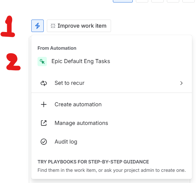

Varsha Joshi
October 2, 2025
Since you set it up as manual trigger. For your testing purposes select a test work item - open it up in your browser and find the lightning bolt icon that is #1 in the picture below and #2 is where you will find your automation, click that it should trigger your automation.
Also please be extra cautious that you have test data to play with.

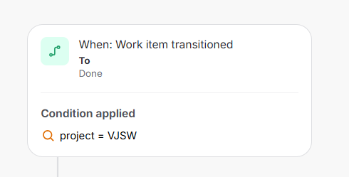

Varsha Joshi
October 2, 2025
You could use the transition trigger and apply your JQL condition. That will run every time any work item moves to Done. Then add the component to run the API to move it to archive.

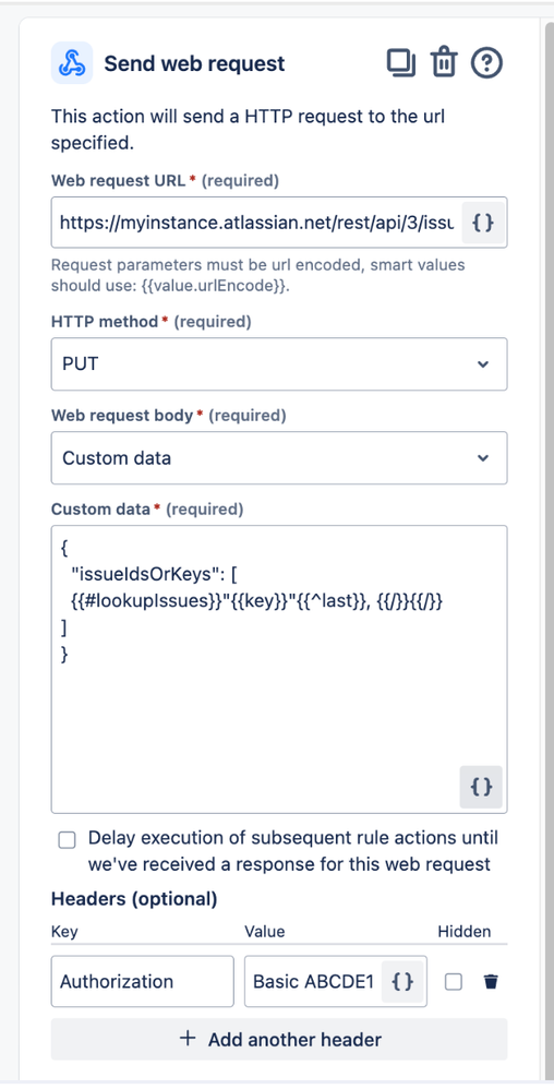

Joel Fraser
October 2, 2025
@Bill Sheboy  thanks for your reply. Yes I did include the extra header as shown below:
Bill Sheboy
October 2, 2025
@Joel Fraser -- I do not see the experimental header in the image you show.
For example:
Joel Fraser
October 2, 2025
@Bill Sheboy thanks. I see what you mean. I thought what I used was the correct header based on the instructions from an article but based on what you are saying I don't have the correct header included. The one you provided in the last screen shot, is this the correct header to use?

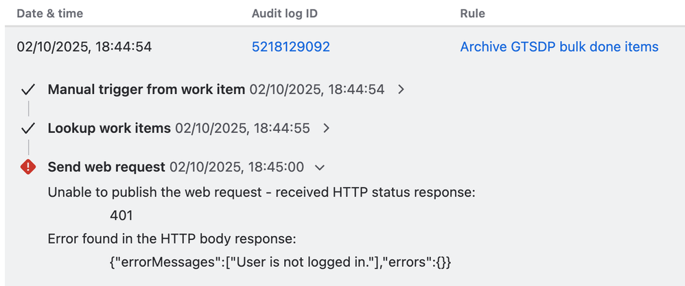

Joel Fraser
October 2, 2025
This is the error I am seeing:
Bill Sheboy
October 2, 2025
Was the API Token you are using created for a user with sufficient permissions to use that endpoint: Jira Admin or Site Admin?

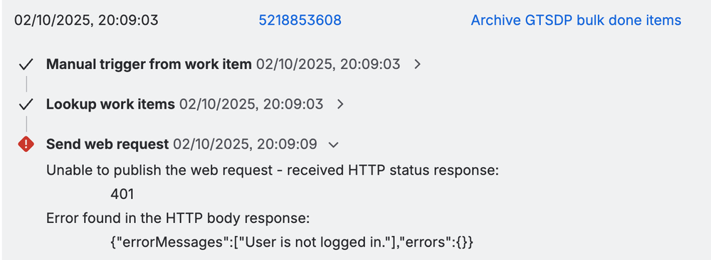

Joel Fraser
October 2, 2025
I just did but I am still getting errors:
Bill Sheboy
October 3, 2025
Have you confirmed that token works with other endpoints (e.g., get a work item) by temporarily changing the action's URL and data, using the validate function in the action?
If so, it may be time to ping Atlassian Support for suggestions.
