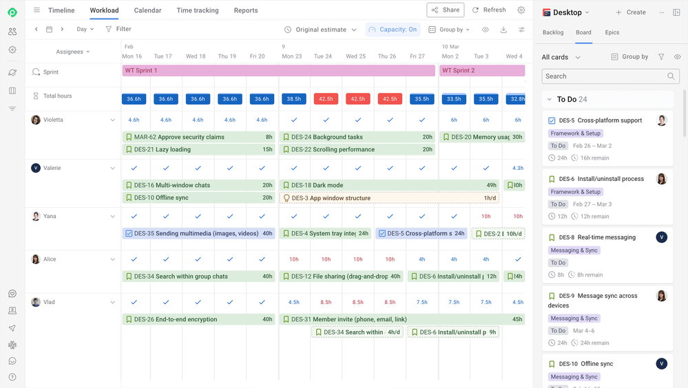

Hi Carmine,
Unfortunately, Jira Plans doesn't flag individual overallocation.
You can extend your setup with Planyway.

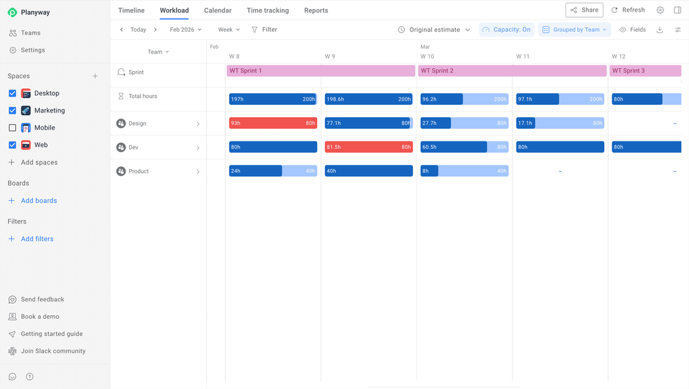

Its Workload view shows each person's planned work alongside their available capacity, even if they're assigned to work across multiple Jira projects or teams. Capacity is calculated based on each person's working hours and workload scheme, while also accounting for holidays, vacations, sick leave, PTO, and other days off. Each team member has a workload indicator that updates in real time as you schedule or reassign issues. When someone exceeds their capacity, the indicator turns red, making it easy to spot overallocation before the sprint starts.
Once you've identified an imbalance, you can rebalance work directly from the planning view by dragging tasks to different dates, adjusting durations, or reassigning issues to another teammate. You can also switch between team-level and individual views to understand where capacity constraints are coming from.

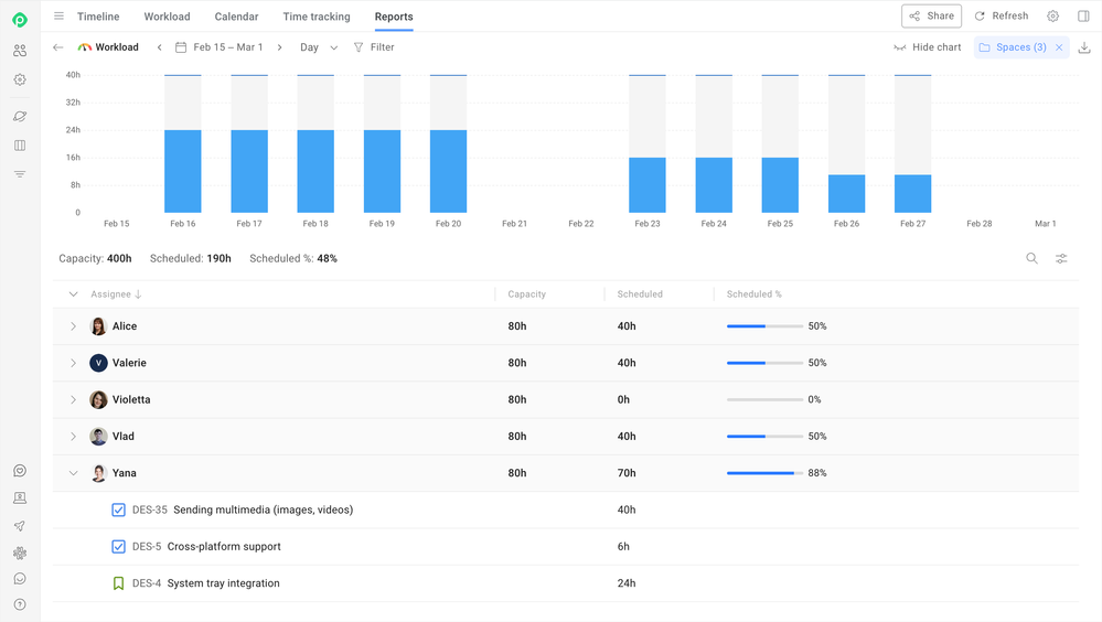

For a higher-level perspective, the Workload Report compares scheduled work against available capacity over any selected period. It's a good way to identify trends, see whether certain teams are consistently overloaded, and make more realistic sprint or roadmap commitments before work begins.

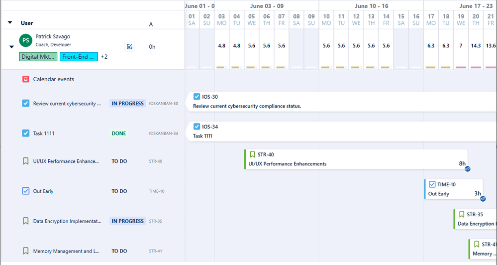

Hi @Carmine -
Sprint capacity gaps almost always come down to the same thing: you can see what's in the sprint, but not what else your people are committed to outside it.
Jira Premium Plans helps at the roadmap level, but for sprint-level capacity, a lot of teams add a dedicated planning layer. Tempo Capacity Planner's Resource Planning view shows each team member's availability across a weekly or daily view, with color indicators for overbooked vs. available time – so before a sprint kicks off, you can see whether you're loading people to their real capacity or stacking work on top of existing commitments.
You can plan time at the issue level directly on the timeline, and it accounts for time planned across all projects, not just the current sprint. That's usually where the surprises are.
