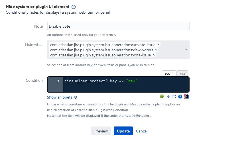

I want to hide only voters information from issues (my jira instance version 7.12) and I find out a lot of variants to perform that, but all of variants are not working.
1. First method to inject ajax calls in jira. Problem in that, I haven't power script plugin in my instance. There are anyway to inject ajax calls with other methods or with script runner ?
AJS.$("#view-voter-list").parent().parent().hide();
AJS.$("#view-voters").hide();
AJS.$("#toggle-vote-issue").hide();
2. To use groovy build in script - Hide UI Element Built-In Script. I have groovy script plugin and tried to do that but something went wrong and voters already appear in issue view screen. Other elements like clone, duplicate and etc. are manageable via this script
Please help to hide voters via script runner scripts or with other methods.
