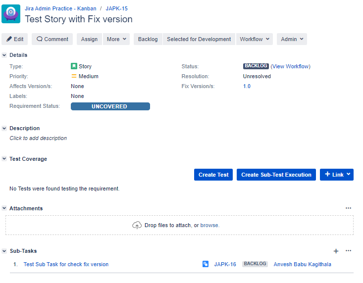

Hello @Jessica Ren ,
Me also tried as mentioned by you.
Kanban board --> selected a story (JAPK-15) --> in the issue  detail view --> I'm able to find number sub-tasks.
When i open story (JAPK-15) via issue view --> I'm able to view The sub -task
Detail view present on Boards --> so same board filter view is applied here also.
Issue view is from Project --> so no board filter restrictions applied here,
Thanks.
