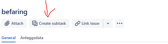

Hi,
Is it possible to remove the option create subtask button from the menu?image.png

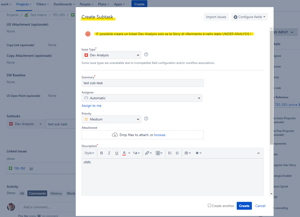

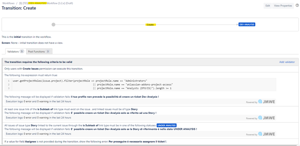

Hi @Stig Tore Skogly Nilsen
in CLOUD there is no way to hide the "Create subtask" for Standard tickets or "Create issue in epic" for Epic tickets..
The only way (at least) to block the creation of a subtask when created is to add some validation in the workflow "Create" transition of all the sub-task issuetypes in your project, where you prevent the sub-task creation if the parent status is not the desired one, or some other controls:
