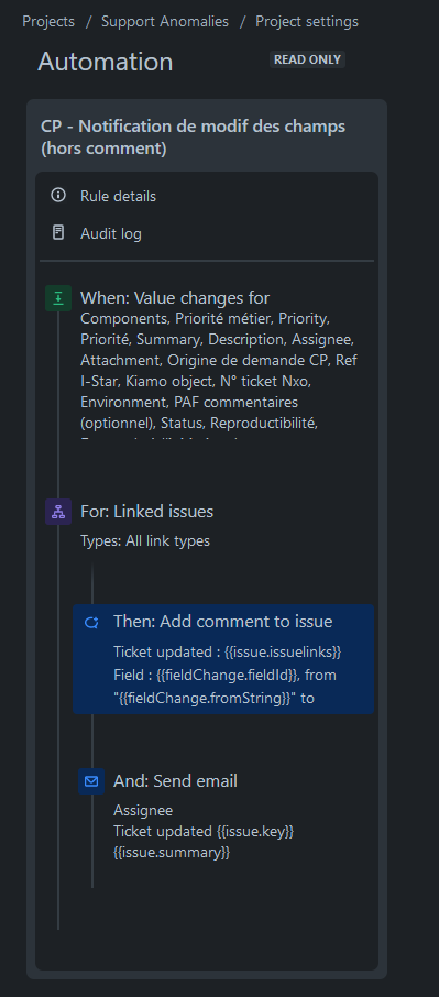

Hi @mgouirand - it would be helpful if you can provide a screenshot of your actual Automation Rule or the comment/notification part of it, so we can see what your "code" looks like. Thanks!
Hello @Darryl Lee Please find the screenshot of the automation and the existing rule.
Thanks for your help.

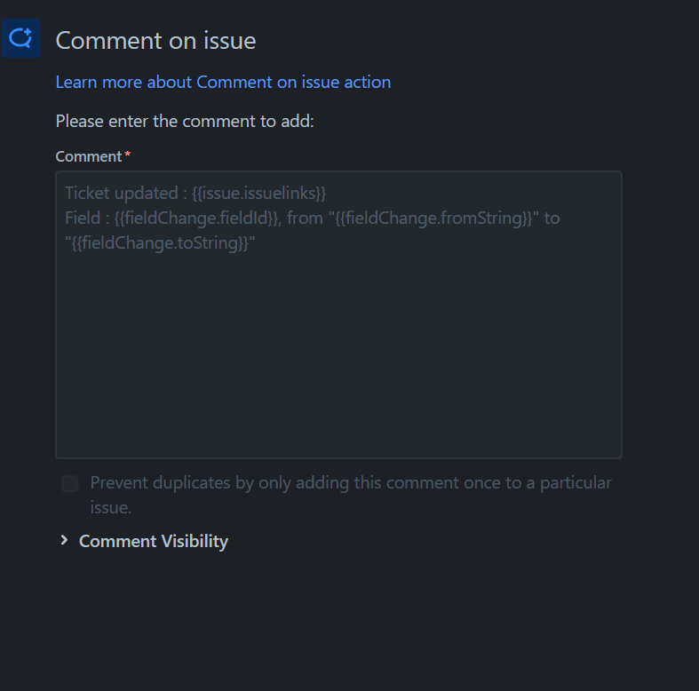

Thank you! I would try:
{{fieldChange.fieldName}}
{{fieldChange.field}}
{{fieldChange.name}}
(Weirdly on my test instance, I cannot even get {{fieldChange.toString or fromString}} to show me anything.)
OK, tested, and it looks like we have a winner:

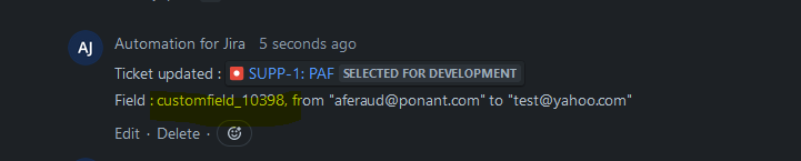

No it means that with "{{issue.Custom fieldname}}", now I have :
Field : , from "test@yahoo.com" to ""
instead of Field : customfield_10398, from "test@yahoo.com" to ""
By no value I mean that I have now :
Field : , from 'test@yahoo.com" to ""
instead of :
