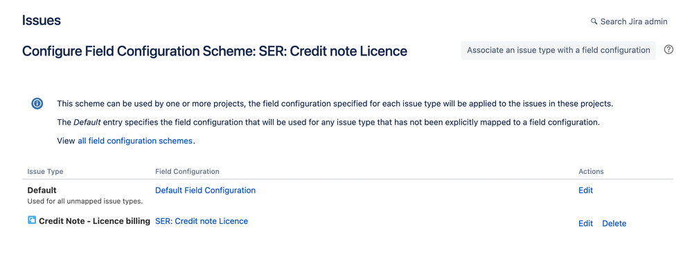

George Bettley January 25, 2021
Thanks Mohammed. So I've completed those steps before however in the Project I can only seem to choose one field configuration scheme, which is default. I want different configurations for different issue types within one Project. Is this possible please?Screenshot 2021-01-25 at 11.56.42.pngScreenshot 2021-01-25 at 11.58.34.png

You are confusing "field configurations" with "field configuration schemes" (a very easy mistake to make, I've never thought it was clear)
  • A "field configuration" is a list of all the fields, with flags to set their behaviour.
  • A "field configuration scheme" is a list of all the issue types, which tells a project which "field configuration" to use for each issue type in it
You only need one field configuration scheme, but that scheme can point to many field configurations.
The minimal example is you create two field configurations; let's call them "FC - bugs" and "FC - everything else".  Set the flags you need for your different acting fields in those two.  Then create a field configuratin scheme (FCS), and tell it "by default, use 'FC - everything else' but for Bugs, use 'FC - bugs'".  Associate that with your project, and you'll find most of your issues behave in one way, and bugs are different.
Thank you! That makes total sense, have finally worked it out. Appreciate it

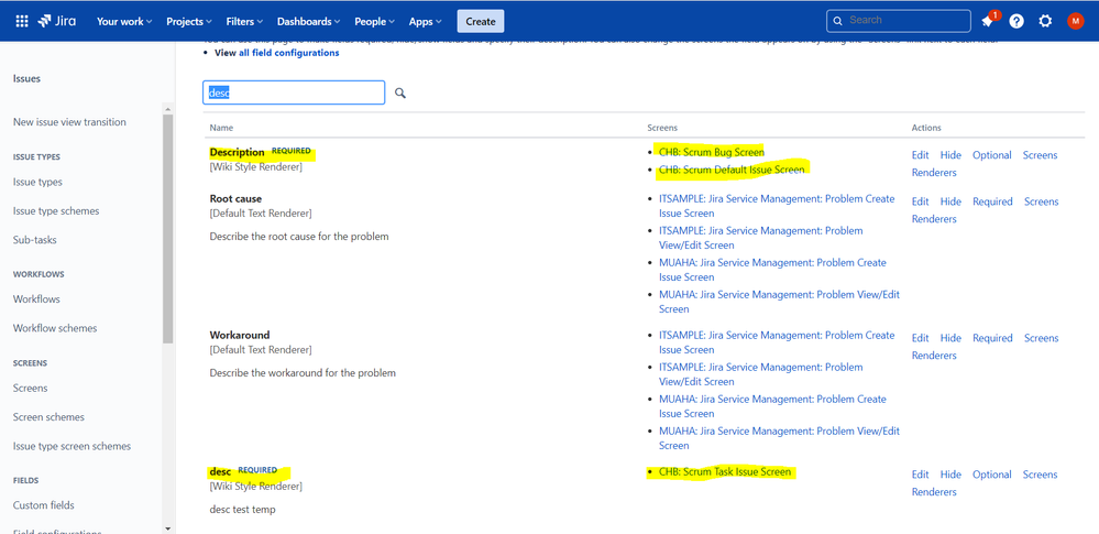

More specifically: "Description" Field to be required for screen 1,2
And "Desc" field to be required for screen 3
Problem:
While trying to create a task using screen 3, I get an error saying that Description is a mandatory field.
Can you please advise? Ay idea of what I may be doing wrong?

I am not sure what you mean by "field scheme", but there's a deeper problem - you are guessing that Jira does "field on screen can be mandatory" via the field configurations.
This is the wrong assumption, it does not.
When you flag a field as mandatory in a field configuration, then the field is mandatory on the project/issuetype the field configuration applies to.  Screens are irrelevant, the field must be filled when you create an issue, and you cannot blank it out during an edit or transition.

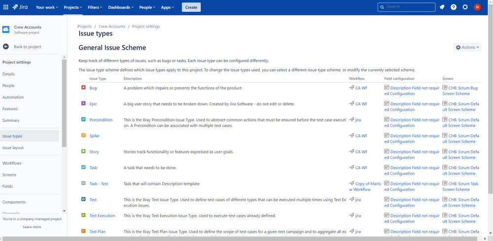

So From what I can understand here, Per project we have issue type, for each issue type we have a specific Field configuration that applies to and a screen that is associated with that issue type: (Project > Settings > Issue types) as shown below:

Nic Brough -Adaptavist-
November 8, 2021
That is what the field configuration scheme does - it tells the project which field configuration to use for each issue type.
