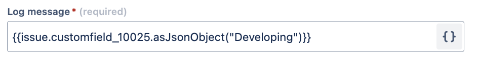

I want to track "Time in Status" = "Developing" for each subtask, so i use Jira Automation to store that value to a custom field.
How to get value "Time in Status" = "Deveploping" in Jira Automation Smart value?

Thái Lê Hoàng
July 31, 2024
I want to store the value of "Time in Status" = Developing for each subtask. This is an automatic customize field of Jira.

Thái Lê Hoàng
July 31, 2024
Are you saying you already have that information recorded in a field named "Time in Status", and you want to sum up the values in child issues and record the sum in the parent issue? >>> That's right!!
As I described above, "Time in Status" is an custom field, it store value in JSON format. Look at the picture below for detail.
I want to get convert the result to "Hours" or "Minutes"Variable.pngJson_Result.png

According to the documentation for asJsonObject:
"Transforms a text value into a JSON key/value pair object. The keyName property is used as the name of the field, as shown below."
I haven't used that function before.

Trudy P Claspill
August 2, 2024
It seems like you might be referencing the native "[CHART] Time in Status" field.
Looking at another answer provided by @Mehmet A _Bloompeak_  in this other post it seems like you would need to parse the data in the Json object to determine which portions of the entry represent the time spent in the Developing status for each of the child issue, and find a way to sum that up.
What you want to do is beyond my expertise for text parsing and Automation rules.
In general terms I think it would be necessary to pull the information from the Json object and then store it into a field in each child issue. Then you could use a separate steps to sum up the values through a Lookup Issues action.

Thái Lê Hoàng
August 4, 2024
Thanks for your support.
I couldn't convert Json format to number (minutes/hours), anw I found a work around solution as below:
  1. Capture actual time when issue start developing.
  2. Capture actual time when issue end developing.
  3. Store duration diff between #1 and #2 in an custom field.
Maybe this isn't the best solution, however it work for our context at this time.
