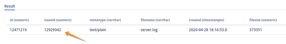

@Abhijeet Kale You can try the below steps to get the issue-key from attachment id
  • Identify the issue-id from the attachment-id from the database
SELECT * FROM fileattachment where id = '12471219'
You will get an issue-id from the query result like below
Then find the issue-key using issue-id, you will get the details as shown in screenshot below
https://<basr-url>/rest/api/2/issue/12929342/
Let me know in case of any issues.
Abhijeet Kale
June 7, 2021
Thanks @Sagar Mahajan I am able to get the issue-key from attachment id from above steps.

If you go this route, use some joins to go ahead and get all the information from the database.
select a.id as attachmentId,concat(p.pkey,'-',issuenum) as issueNum, filename
from fileattachment a
left join jiraissue i on i.id = a.issueid
left join project p on p.id = i.project
where a.id in (30604,26718,30700)
