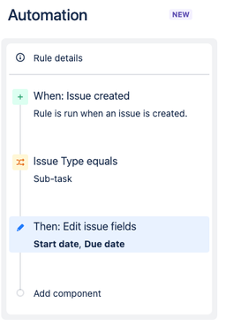

Here is Rule #3:

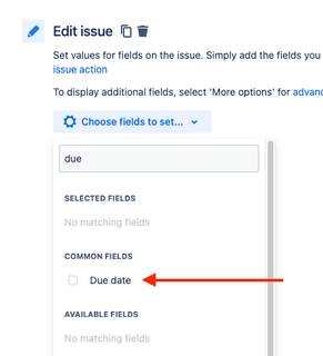

A clever part of this rule is the Edit Issue action.
First you have to select the field you want to edit. (Note that you can edit more than one field in the action.)

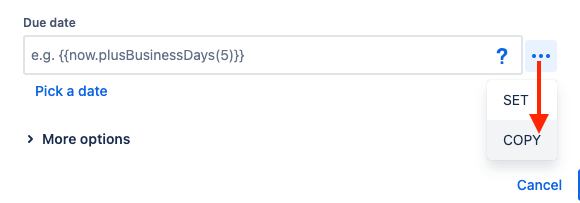

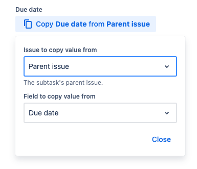

After you select the field, initially you'll see an empty field where you can enter the value you want to assign to the field. The clever part is you can actually select to Copy the value from the parent issue thus:
Click the three dots to the right of the field and select Copy.
That changes the entry field to look like this. Then click on the text displayed in the entry field.

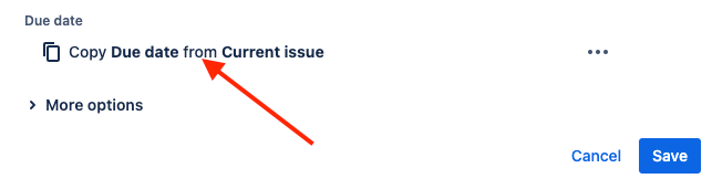

When you click on that text you get a pop-up where you can change the source issue you want to copy from, and even the field you want to copy from. You would want to select Parent Issue as the source.
Screenshot 2023-11-14 at 9.46.23 AM.pngScreenshot 2023-11-14 at 9.46.33 AM.png

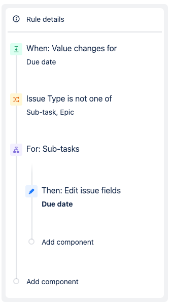

For Rule #2 here is an example. You should be able to extrapolate from this to create Rule #1.
The Trigger is Field Value Changed. You specify the field you want to monitor with this rule. When that field changes, this rule is triggered.
The next step is to add a condition to check the type of issue in which the field changed. You don't want this rule to run if the field changed in a Sub-task or an Epic, as neither of those issue types has child subtasks itself.

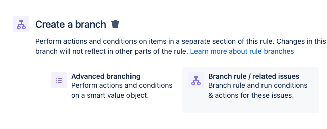

The next step is a For Each branch. At this point we know that the issue type whose field was changed is not an Epic or a Sub-tasks, so it is a type of issue that may have child subtasks. We want to update all of its child subtasks.
After selecting the For Each branch you want to select the Related Issue option.

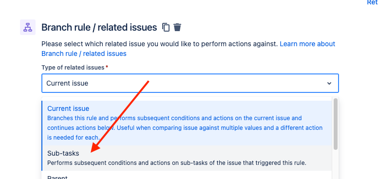

Then choose the type of related issue. In this case you want to execute action(s) For Each Subtasks
Then within the branch you want to add an Edit Issue action, just like you used in Rule #3.
You can use this same rule structure selecting Start date as the field you want to monitor and Edit, for Rule #1.
