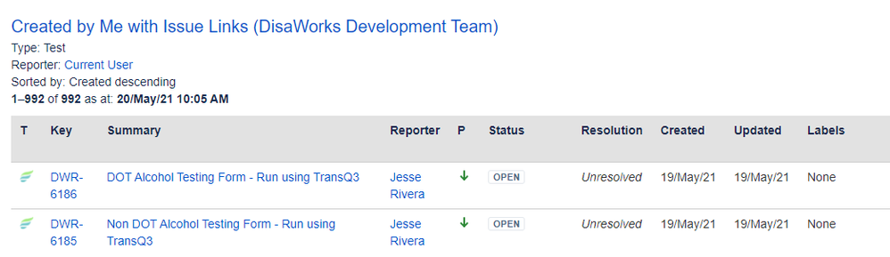

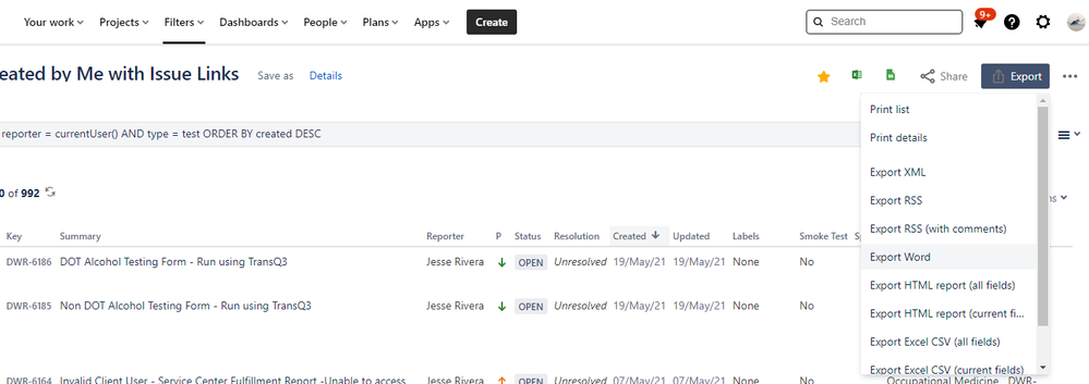

The best way I have found, using Zephyr Jira is to use the options under Export, inside the Filters page.
Once you have created your jql query, Click on Export, you will see the Print list option.
Clicking on Print List will open a new tab with the same list from the last page.
It will also give you this line: 1 – ### of ### as at: Day/Month/Year Time.
That ### is the number you are looking for.
Print List Option:
Printed List:
