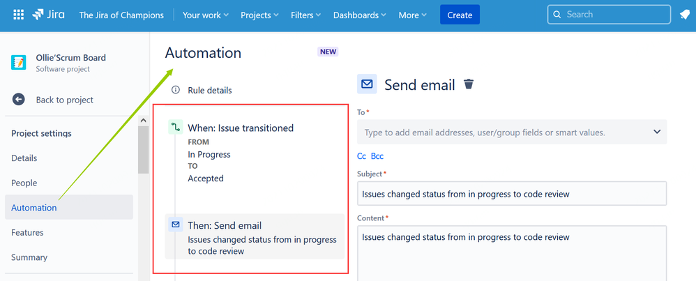

Automation
Send email When Issue Transitioned From In Progress to In Review Then Send email to sb@xx.com

You should implement a Projekt Automation  with the Trigger transition and send a email when is happend.

Hi @Rolf Okken ,maybe by sending a email would be better. Could you tell me more about how to achieve this?

An other way receiving Information by mail is Project Automation. Please read this before we start  to discuss this topic. https://support.atlassian.com/jira-software-cloud/docs/automate-your-jira-cloud-processes-and-workflows/
