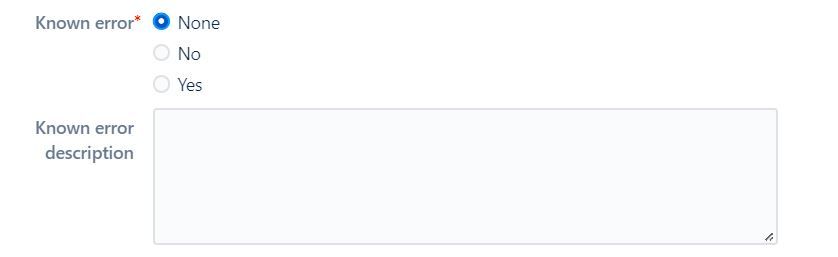

There is a field Radio button Know error with option Yes and No.
If Yes is selected then the field Know error detail should be visible and mandatory.
If option is "none" and No, then the field should not show.
Should the scripting be placed within the initialise field or the Know error field?

I have two fields.
Known error -> with options yes and no, and this field is mandatory.
There is a field Known error description, that needs to be completed if the option "Yes" is selected in the Know error field, else the field should not show on the screen.

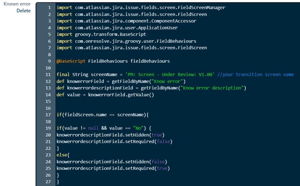

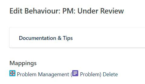

Yes it's mapped.

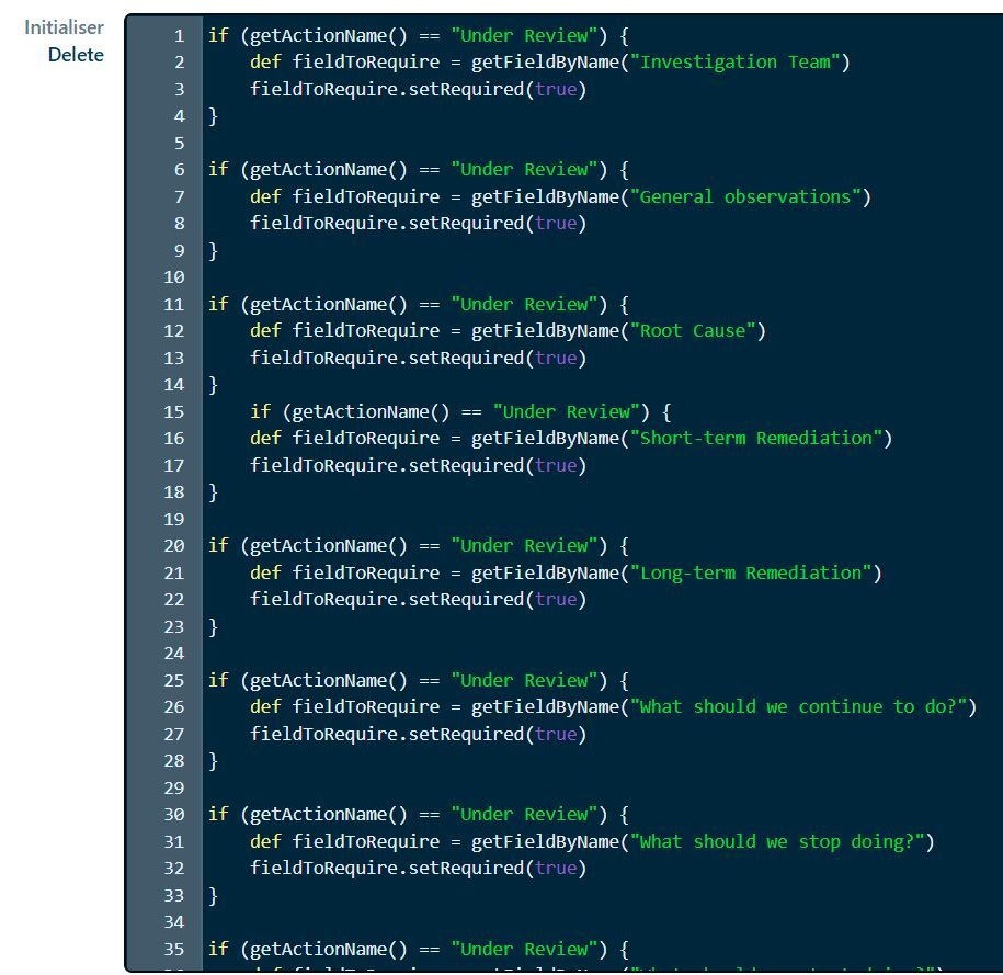

This is the initialiser field detail as well.
This is where I set the other fields to be mandatory

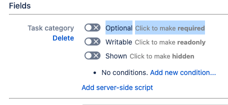

You don't need to write the same condition for the same transition, it's enough to write the condition once and set the mandatoryness of all fields inside.
You can also set it to be mandatory using the switch,
Example:

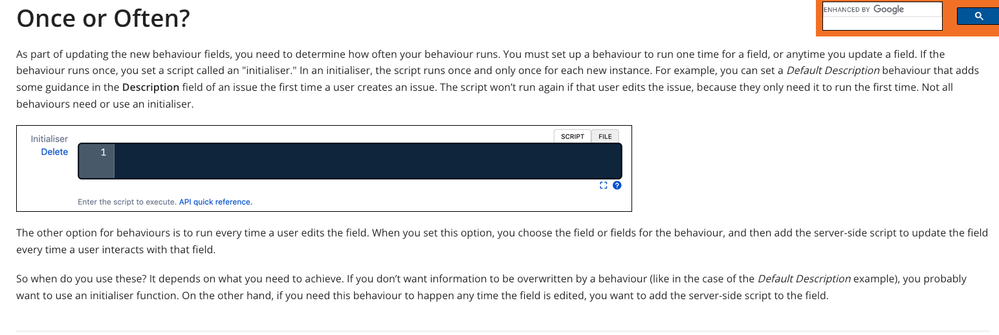

Here is a brief about the work of the initializer:
https://scriptrunner.adaptavist.com/latest/jira/tutorials/behaviours-tutorial.html
Test the script without an initializer.
I need the fields to only be mandatory when the status is changed from "In progress" to "Under review".
Thus on the "Under review" screen.
If I use the Switch for the fields, then it's not working as expected.
It sets the fields to be mandatory regardless or status.

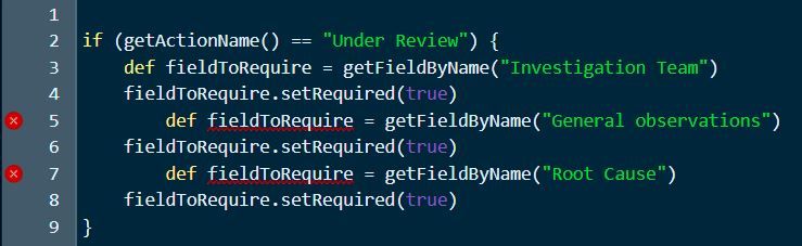

You don't need to write the same condition for the same transition, it's enough to write the condition once and set the mandatoryness of all fields inside. ->How do I do this?
Error message about current scope already contains value for fieldToRequire.
Thanks the "Known error" and "Known error description" fields are now working as expected.
Will ensure I double check spelling.
Since you have it on the screen, only give a name based on the name of the field.
Example:
def investigationTeamField = getFieldByName("Investigatin Team")
def generalObservationField = getFieldByName("General observation")
def rootCauseFild = getFieldByName("Root Cause")
if (getActionName() == "Under Review") {
investigationTeamField.setRequired(true)
generalObservationField.setRequired(true)
rootCauseFild.setRequired(true)
