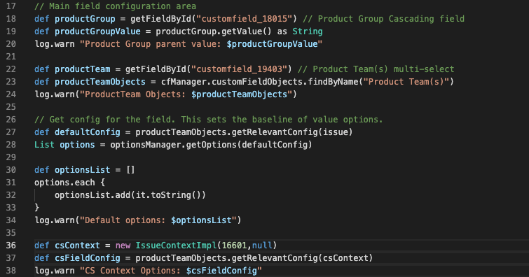

I'm still in a bit of a pickle, which may be due to making assumptions. Everything seems to work fine, but in the logs I'm not seeing the values I would expect.
Here you can see that I'm grabbing the options and making a list to resort to if necessary (Sorry for the photo, it wasn't allowing me to post due to "invalid HTML"):
Everything looks fine, but when I run it the logs don't return any specific options available for project 16601, they return:
2022-11-15 21:51:59,964 WARN [runner.ScriptBindingsManager]: CS Context Options: com.atlassian.jira.issue.fields.config.FieldConfigImpl@91e57469
Is it wrong to assume that getRelevantConfig() only gets the config information, but not the values?
PD Sheehan
November 15, 2022
Correct, getRelevantConfig only gets the configuration context object.
You need optionsManager.getOptions(csFieldConfig) to get the list of options.
Andrew Wolpers
November 16, 2022
Bah- thats it! Thanks Peter.
