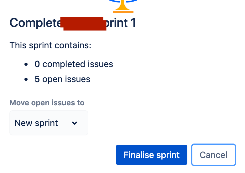

We are using Jira Next-Gen with Atlassians cloud hosting.
I moved Issues from "in progress" into "Done" state. However, when I want to close the current Sprint, Jira still reports all Issues as "open" and asks me to transfer them over into the next sprint.
If "done" is not the right state to complete an issue, how can I achieve that?
Within the **Jira Next-gen** project there is no option to "close" an issue.

The Done column should be the most right column. If it is not the most right column, then the issue is considered as not completed. You can not change this behaviour.

Is it a global thing that issues can't be completed then anymore? or something we can do with configuration?
Alexey Matveev
March 25, 2019
It is built in Jira Software. Issue must be in the most right column of the board to be completed
Hagen Huebel
March 25, 2019
Many thanks! This was the solution.
My issue was, that i've added a second column at the end for postponed items. Moving them to the left solved my problem.
