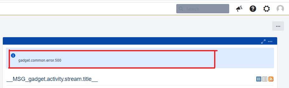

Getting gadget.common.error.500 error on the dashboard.
Jira version : 8.13.3
OS : Windows
Https Only : Yes
Port # : 8443
Cert Type : JKSgadget-error.png
Nic Brough -Adaptavist-
March 31, 2021
This error means that the Jira server cannot reach itself over your network.
The two most common causes of this I see are
  • Poorly configured networks that don't allow the Jira server to resolve and connect to its own base url
  • Incorrect SSL settings - the Jira server can connect to itself, but has not been configured with an SSL certificate to negotiate the connection correctly
It is usually the second one, which is a bit more complex to diagnose.  But first, log into the Jira server and try "nslookup <your jira base url>" - if that comes back with a valid response, then try a wget on it - you'll get a block of text that either contains the html for the login page (if everything is set up right) or an error message that will tell you more.
Srinivasa Ragavan Ayyakutti
April 2, 2021
Seems to be a SSL issue. Added the certificate to the Java trust store. The error is rectified.
