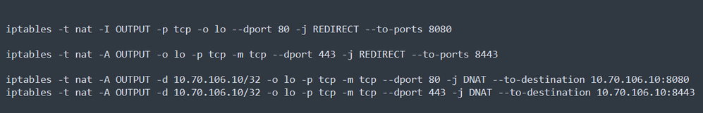

I think traffic is not reaching on port 443 to the proxy server.
Should I add the below lines in the Jira Server:
Charlie Misonne
August 7, 2023
I'm afraid the specific iptables commands are beyond my level of expertise.
