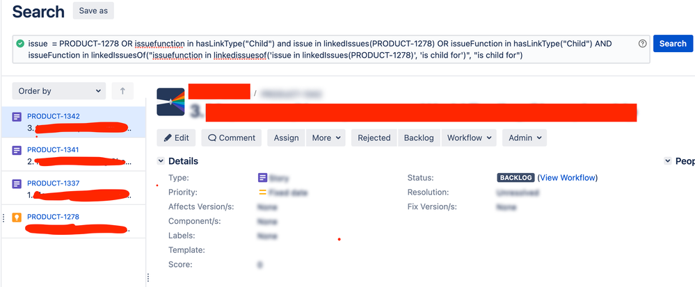

upd: i got to the point when error gone. Don't know why but Jira shows me the results of JQL when i change symbol " to ' in a part of query.
So now i use that:
issue = PRODUCT-1278 OR issuefunction in hasLinkType("Child") and issue in linkedIssues(PRODUCT-1278) OR issueFunction in hasLinkType("Child") AND issueFunction in linkedIssuesOf("issuefunction in linkedissuesof('issue in linkedIssues(PRODUCT-1278)', 'is child for')", "is child for")
but there are only four issues founded. It is the main PRODUCT-1278 and three linked issues with child link type. Looks like part of JQL was ignored.
upd 2: found a stupid mistake, i need to chage type of link in JQL like that
issue = PRODUCT-1278 OR issuefunction in hasLinkType("Child") and issue in linkedIssues(PRODUCT-1278) OR issueFunction in hasLinkType("Child") AND issueFunction in linkedIssuesOf("issuefunction in linkedissuesof('issue in linkedIssues(PRODUCT-1278)', 'is parent of')", "is child for")
but the result of search is +1 issue that really has link type "is child for" with one of linked issues "from 1st level". But there are lot of the same issues, not only one.
