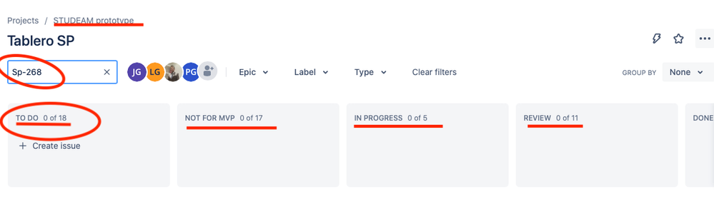

Captura de pantalla 2020-11-18 a las 18.02.45.pngCaptura de pantalla 2020-11-18 a las 18.03.55.pngAs the set of pictures describe, I can access Issue/task SP-268 thanks to the link in Slack, however when looking in the board directly does not show at all.

Sorry as I might be using wrong wording as I translate in my mind from Spanish concepts to English concepts, and might not use the proper wording. However I think these two pictures explain better the trouble I'm experiencing.

The screenshot is a great way to avoid that barrier though, it's perfectly clear, thank you for taking the time to do that!
This tells me that your board is not selecting the issue for some reason.  There are two steps to "debug" this next:
  • Click on the "Clear Filters" option.  This will clear out any display filters you have missed or forgotten, which might be hiding the issue
  • Go to "configure board" and look at the filters the board is based on - could they be excluding it?

There are no filters applied anywhere. Basically any new issue created is not shown, making Jira useless for our project if not solved properly.

As explained by the pictures.
I create an issue.
As we have have a connection to Slack the issue shows up there.
I can open the issue from the link in slack and it works perfectly.
However I can't find it anywhere in the board, as shown in the second picture.

Boards are built on filters.  The fact it is not on your board means that the board is not selecting for the issue.  You need to look at what the board is selecting for and why

I have removed all filters and still I can't see the issue.

Ok, so what type of board is it and what is the board filter?  (depending on type, it may not have one you can see or edit)
