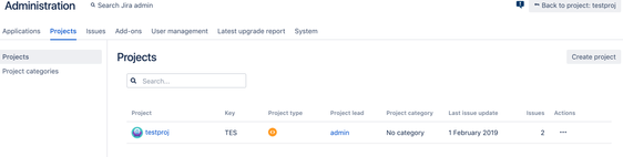

Hi @Narendra Kumar ,
Under Administration > Projects there's a column where you can see the last time an issue was updated in the project.
@Edwin Kyalangalilwa, is that an image from Cloud? Not sure it is and I do not have that field in my Projects page and I checked another instance as well w/o success. I wonder if this is Server specific?
You're right, i missed that this is a question related to cloud.
@Narendra Kumar Please disregard my above answer.

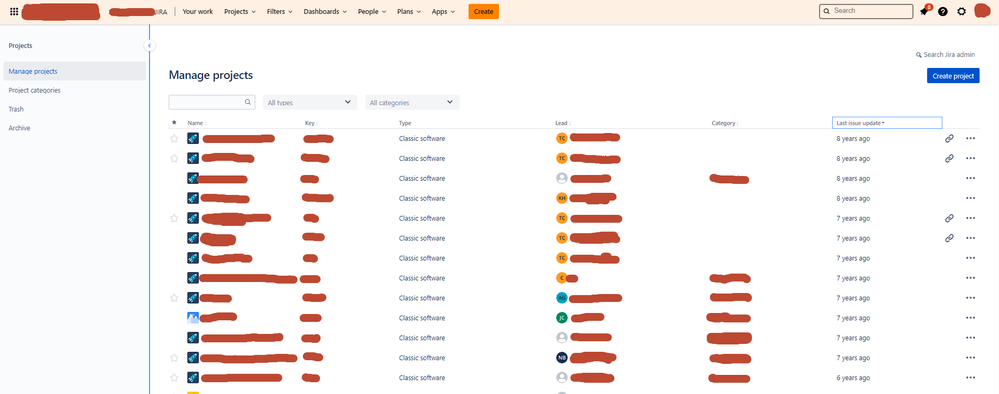

Hey, just to update this old thread with new information :-)
This is now available in CLOUD! See Screenshot from one of my cloud instances... Yup, you can now see "Last Issue Updated" and sort by that in the manner @edwin mentioned above!
@Russell Zera , is this standard or premium? I don't see in my standard instance (yet).
ohhhh nooooooo... Premium strikes again! sorry... I'm on Premium
