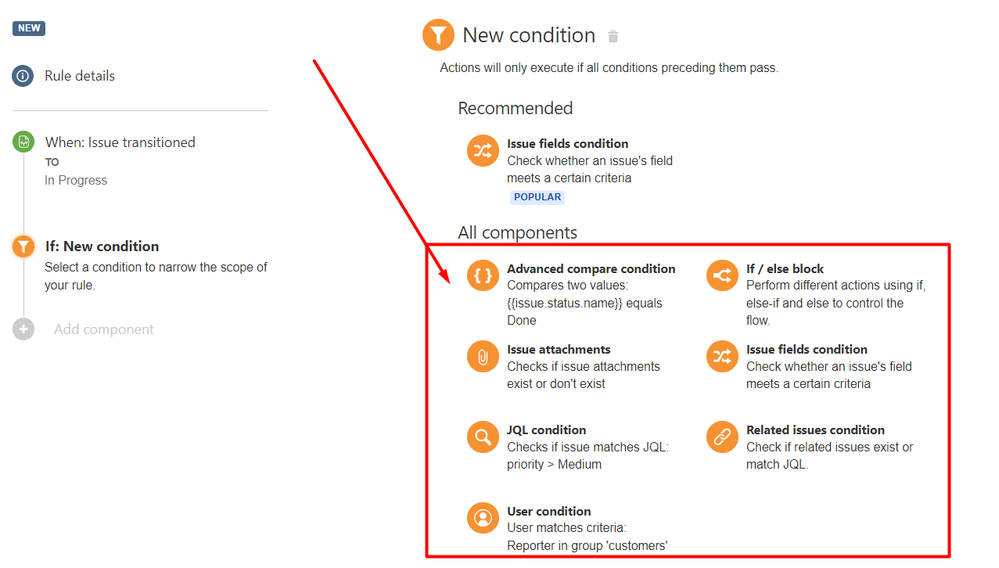

Thank you for your reply, but... I don't see this condition: maybe you use Cloud Jira? In our Jira Server there are these conditions:
And I'm not sure if Start Date in your screenshot is the same as field "Target Start" in Jira Plan...

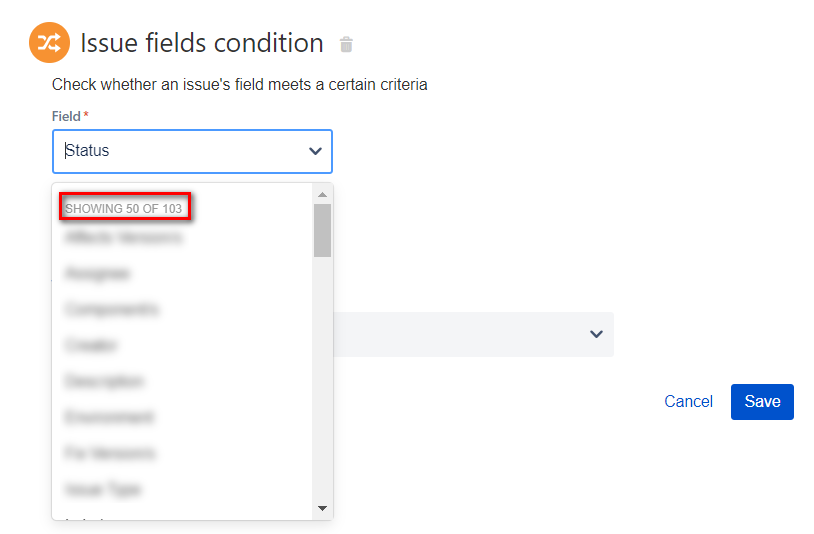

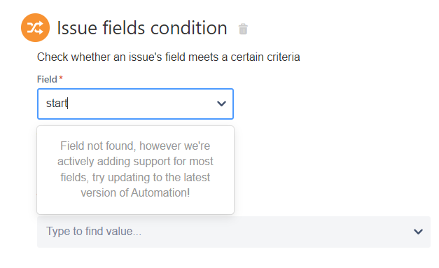

I carefully have looked up to this condition "Issue fields condition". And didn't find "Target Start" and "Target End" fields:
At the same time I've found out that not all fields were displayed in drop-down-list "Field":
So, I've wrote about this to our Jira Support with request to display "Target Start" and "Target End" fields if they there are. But Support specialist said:
The "Target Start" and "Target End" fields are non-standard, they are created by the "Portfolio for Jira" plugin, so they are not displayed in Jira Automation. I tried to fill in the date via a post function, but this did not work either. Alternatively, we can create two other custom fields and use them in the plan.
