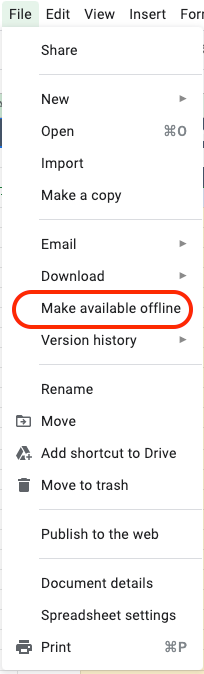

Edwin Meijer
January 31, 2021
Enabling the sheet offline (see below) before downloading did the trick for me;
thanks!
